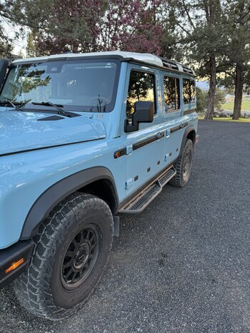

I fitted my new Fox AT2 yesterday. Set on 14 clicks as recommended.
Initially finding is steering is lighter . Having adjusted my lock stops it goes lock to lock without any effort.
Centre return feels the same but i need to do some more miles and fine tune it to my personal taste .
