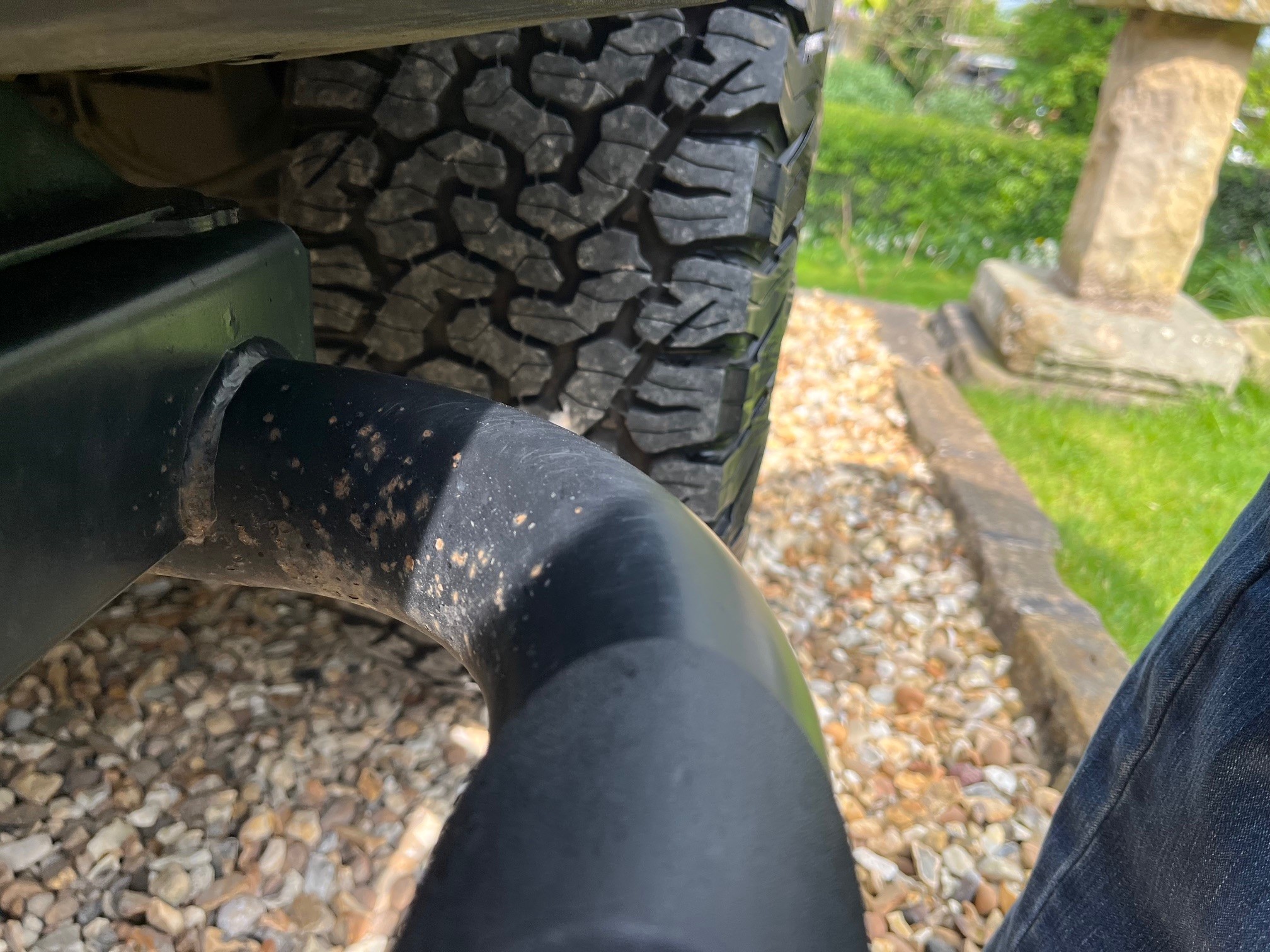

Hi All
Does anyone elae have Rust on the wheel nuts, locking nut and side bars? These photos are of each wheel and two of each of the side rails.
Maybe the salt used on the North Yorkshire roads doesn't help but this isn't good, I have done just less than 16,000 miles in 53 weeks.
My dealer say (always found them very good) that this is not a general problem and that they are awaiting a response from Ineos Automotive - and have been for quite a few weeks.....

I’ve done 8,500 miles on Northumberland & Scotish Borders heavily salted roads and have nothing on wheel nuts. I have a few rust spots on side steps , yours seem heavily pitted and rusted in comparison.
Bad plating on the nuts. Replace, as Alloy wheels deserve proper nuts.
Sand abrasion on the bars.
More than likely, the bars will need regular attention with tractor paint (epoxy hardener added)

I'm guessing the powdercoat on the bars is very thin to start.
My side steps are rusty but have had a hard life on dirt and gravel roads. When I get the vehicle back I will remove them, clean them and use rust converter. I will probably treat all underneath with Lanoguard in the summer also. No rust on wheel nets that I’m aware of
Look up a company website called Bilt Hamber, despite the name sounding possibly German (nothing wrong with that), they are a British company.
They are well known for car cleaning products and also rust inhibitors for vehicles. They do one for inside chassis’s and one for everything. Else under a vehicle, I am going to do all of mine in this stuff.
Like others say your steps look a lot worse than many others, but the OEM steps seem to have a rattle can paint finish from China, the dealer/IA might say replace but will you have the same in 12 months time ?? Or you could just bite the bullet, sand them, rust treat them and put some tractor paint on them and then double down with a Bilt Hamber treatment….belt and braces.

I am sure all of this is covered under the warranty. The rock sliders rusting is clearly an inadequate powder coating manufacturer defect.
Cheap Chinese steel and poor powder coating. I had rock sliders on my Patrol for years in harsh Outback conditions and they still looked way better than that INEOS mistake.
I had a 18 year old work ute up until recently with less rust around any wheel component or fixing than you vehicle is showing which is effectively brand new... lodge a warranty claim. The wheel nuts are very poor in your example... HDG I think not.
In the UK with all the salt on the roads powder coating doesn't stand a chance, even the good stuff won't last, especially in a high impact area. Hence I was happy to pay the extra for the Buzz stainless sliders. What I'd do is take them off, and drop them at your local agricultural fabricators, they can send them off with their next consignment to be hot dip galvanised. You could then paint them with raptor black or similar. Or just get the buzz ones....
