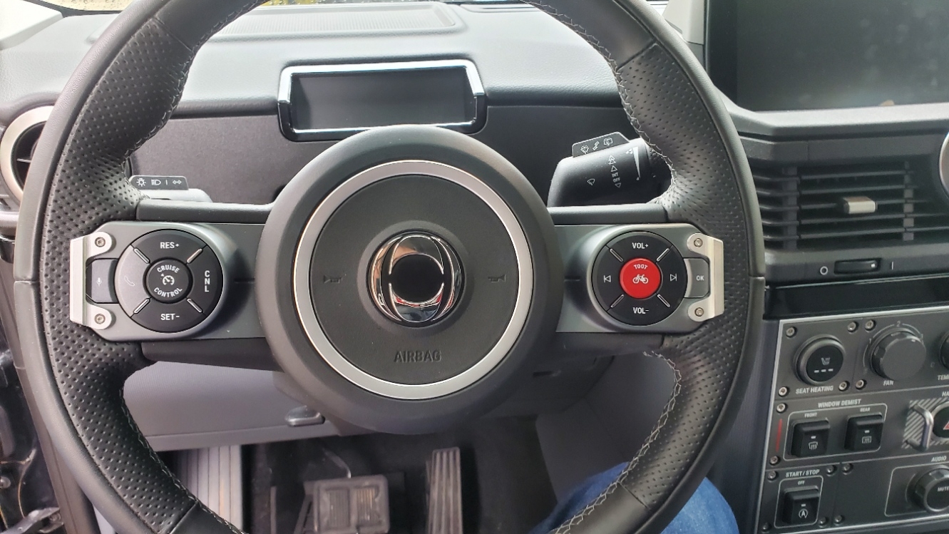

Update: I've refined the design a bit to make fillets on all the surfaces, and decreased the size of the rounded bits. Added more relief on the underside too. It's shown with (imperial) 2-56 hex head bolts, I will be ready to go once I can source longer M2 screw cutting fasteners (like the OEM fasteners) in a slightly longer length in stock. Ali express has them, but will take a few weeks to get them to me. In the meantime, I'll do more driving tests, but so far I think this design is a big improvement over the original design. Thanks everyone for all the feedback and encouragement!

this is a pre-production example while the CNC mill cranks away in the background:

One of the things I like about the interior is all of the aircraft style guards that make you less likely to accidently flip on a switch you didn't intend to.
BUT...
I always hit the microphone button when I'm turning the wheel, especially in parking lots, which annoyingly makes my grenadier listen to what's being said and disrupt the music or my concentration!
To this end, I fabricated a couple of guards that protect these buttons:
It has a recess on the back side so the button is not depressed, and sits about .187 high, just enough so your palm does not hit the button when you turn the wheel, but the button is still easy to press when you need it.
would anyone else be interested in these? The design is still a prototype, but if there's enough interest, I could make up a batch of them.
Please, take my money so I stop hitting that mic button

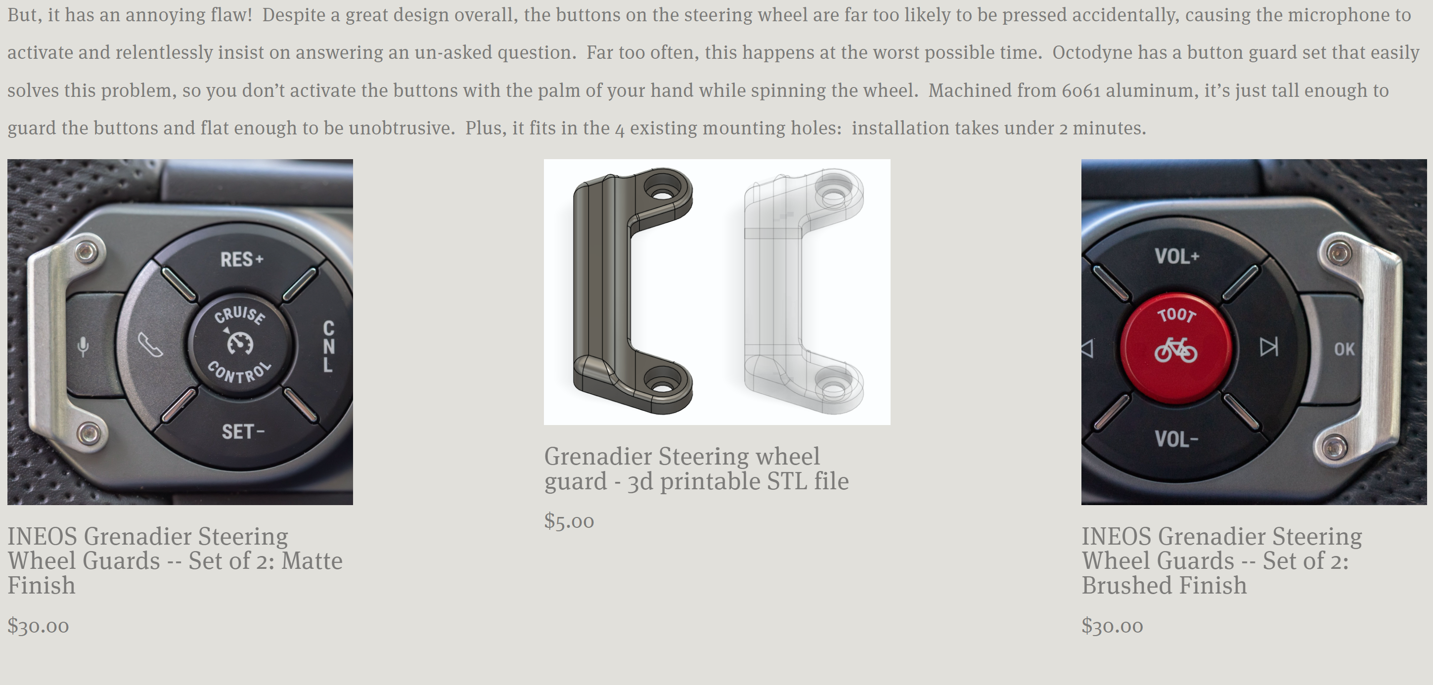

OK everyone.... these are now IN STOCK and ready to be shipped here: https://www.octodyne.com/ineos
A couple of things:
1. You have your choice of brushed or tumbled finishes, but don't sweat it too much, they really look about the same. I'll add more pictures tomorrow.
2. The screws FINALLY came in. The head of the screw is just a little (.020") smaller in diameter that the original, but it still looks pretty close to the OEM part. You may be able to re-use your original screws too, but I'm throwing in some 8mm length screws that will work for sure.
3. Upon checkout, there will be 2 options: 2 day express mail (tracked, insured, etc.) for $8.95 or USPS postal mail (snail mail) for $1.00 as a lower cost option.. these come in just under the 1oz weight limit, so can be sent domestically as a letter.
4. International: I don't think the squarespace ecommerce will allow these to go international. if there is significant interest from other countries, I'll figure something out. Also, if you're interested in buying more than 2 sets let me know and we can work out a wholesale arrangement at a discount. You can send me an email through octodyne.com if you have questions.
please order up, and thank you all for the enthusiasm!
