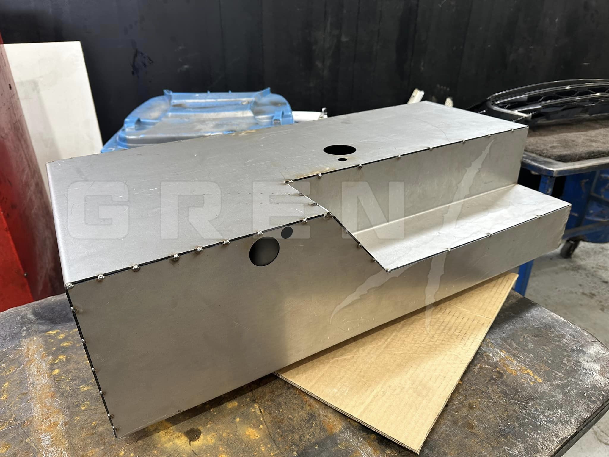

A guy on the IG overlanders FB group has just posted a 68L rear muffler delete LRT

I would have a little concern with removing a 5kg muffler and adding about 80 kg of fuel & tank behind the rear axle.
As long as some thought has gone into the impact on weight distribution, suspension etc.
80kg has the potential to become 120kg pendulum effect and possibly impact your allowed tow ball weight
Don't tow a caravan Dave. Just don't!
i think a lot of people who want the extended range are doing just that, towing a caravan.
They also seem to all want to tow a 4 bedroom house size caravan that weighs about 3500 kgs.
Which is roughly 350 kg tow ball weight.
This tank & location "MAY" impact the maximum 350 kg tow ball allowance.
I have zero idea if it will but it may be a nasty surprise when pulled over by cops to check loads and weights while on holiday.
I'm only towing a 2.65 GTM van so I'll be right.
Everyone else is a grown up and can "do the math". If they are breaking the law they can cop the fine.
