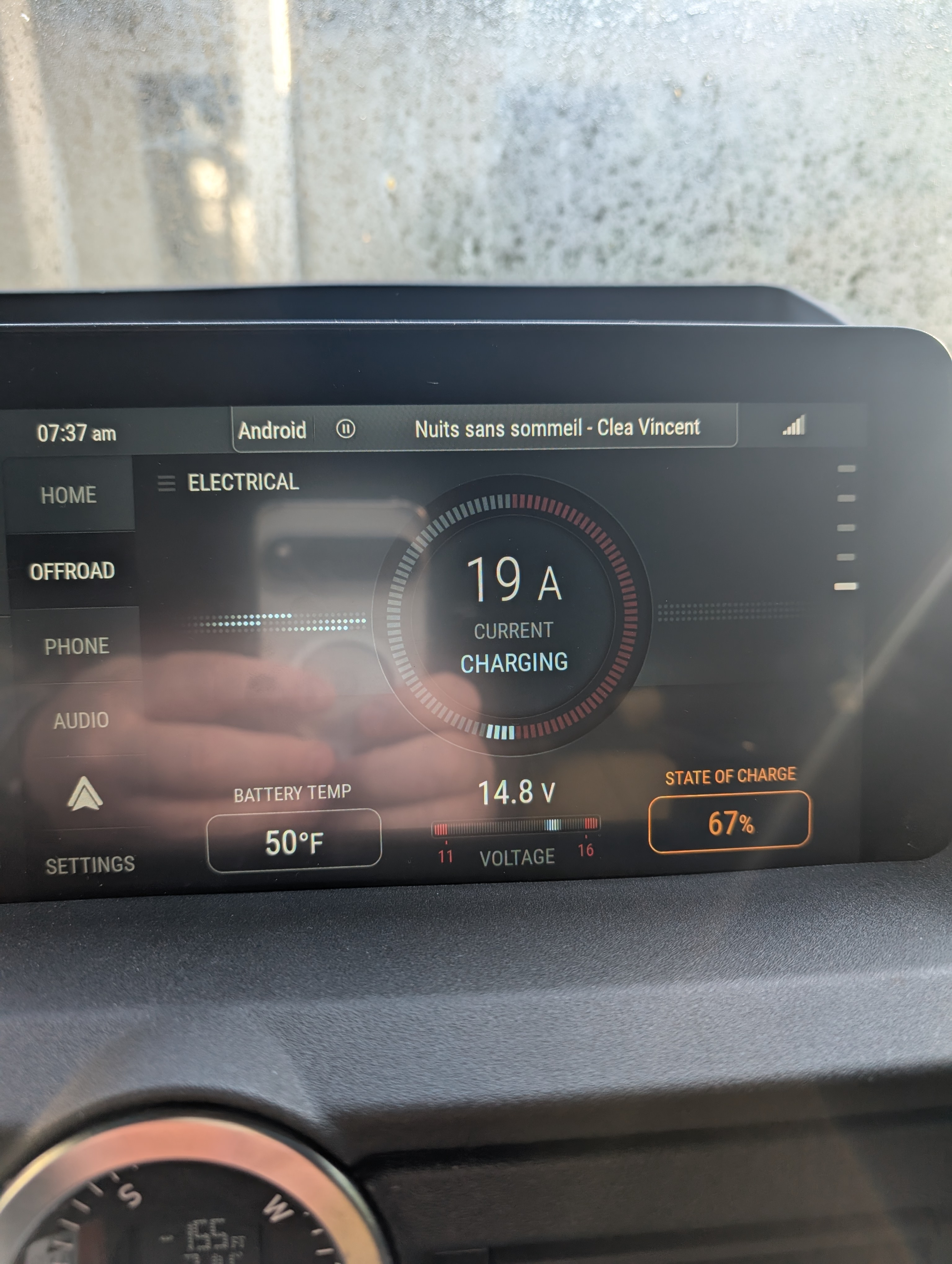

Two more pictures.
The ineos builtin bms thinks the battery is at 67% discharge after 3 weeks and 3 days being parked on my driveway. I do not think this is a real number. I did the math and with my fully charged battery it would suggest that my vehicle consumed 1.5A continuously since I parked. I don't believe that for a second, it's way too much of an low power draw in an parked car with no active accessories. Perhaps the ineos is calibrated with a wrong a peukert coefficient?
My victron on the other hand believes my car consumed 145mA continuously since I parked it. That I believe totally. Sounds about right for low power mode of an alarm and no other active vehicle electronics. Maybe a touch optimistic since I think my Wolfbox parking monitor pulls about 100mA when parked but I don't think it's far off.

Two more pictures.

Hi Parb,
Can you check you calculations as I don't think it is correct.
You were gone for 576hrs (3weeks and 3 days). Therefore if I assume your battery was as 100% state of charge at the start and 67% at the end you would have consume 34.65Ah. If you divide that by the time you were gone that would be 34.65/576=0.06A (60mA) static current.
If the battery was only 90% charged at the start of your trip that would be 0.042A static current.
I also have a smartshunt on my starter battery, I installed it before I went of vacation for 2 weeks. It was at 12.74V when I left, and gradually discharged to 12.49V. The SOC from the car was at 65% when I got back. I don't have the starting number but I think it was about 80%.
The smartshunt did not show a significant reduction in the SoC, but from the manual, if the current is below 0.1A it will record as zero.
