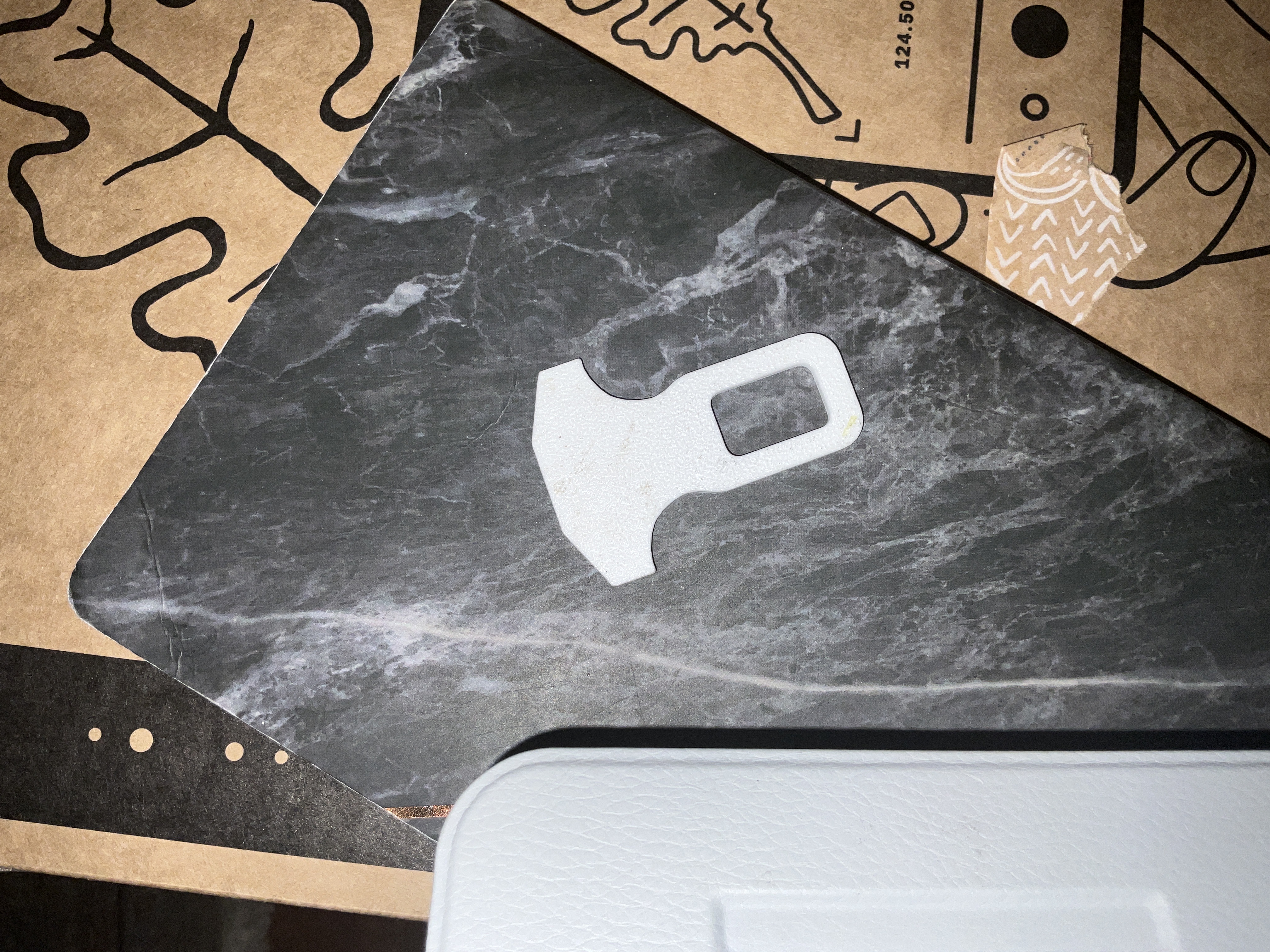

I just 3D printed a small part that mimics the factory buckle. It's unnoticeable aside from a small key ring sized pull. Works flawlessly for my purposes. Though I would love if Ineos had a defeat similar to say a Ford.

A bit late joining the conversation, but I had previously purchased 3D printed seatbelt inserts for my 2021 4Runner at $9 each. The blanks solve the problem, and they are the same size as the Ineos seatbelts. The dealership has seatbelt extenders as well, as someone stated earlier. Just cut the straps off and those work perfect. At our ranch, getting in and out of each vehicle with short stops makes actually wearing the seatbelt a real pain. Of course you could buckle it behind you, before you enter the car, but I would always forget - until the chimes start in. With these blanks, we just snap them in and no annoying alarms sound. Throw them in the glove box once we leave the property.
