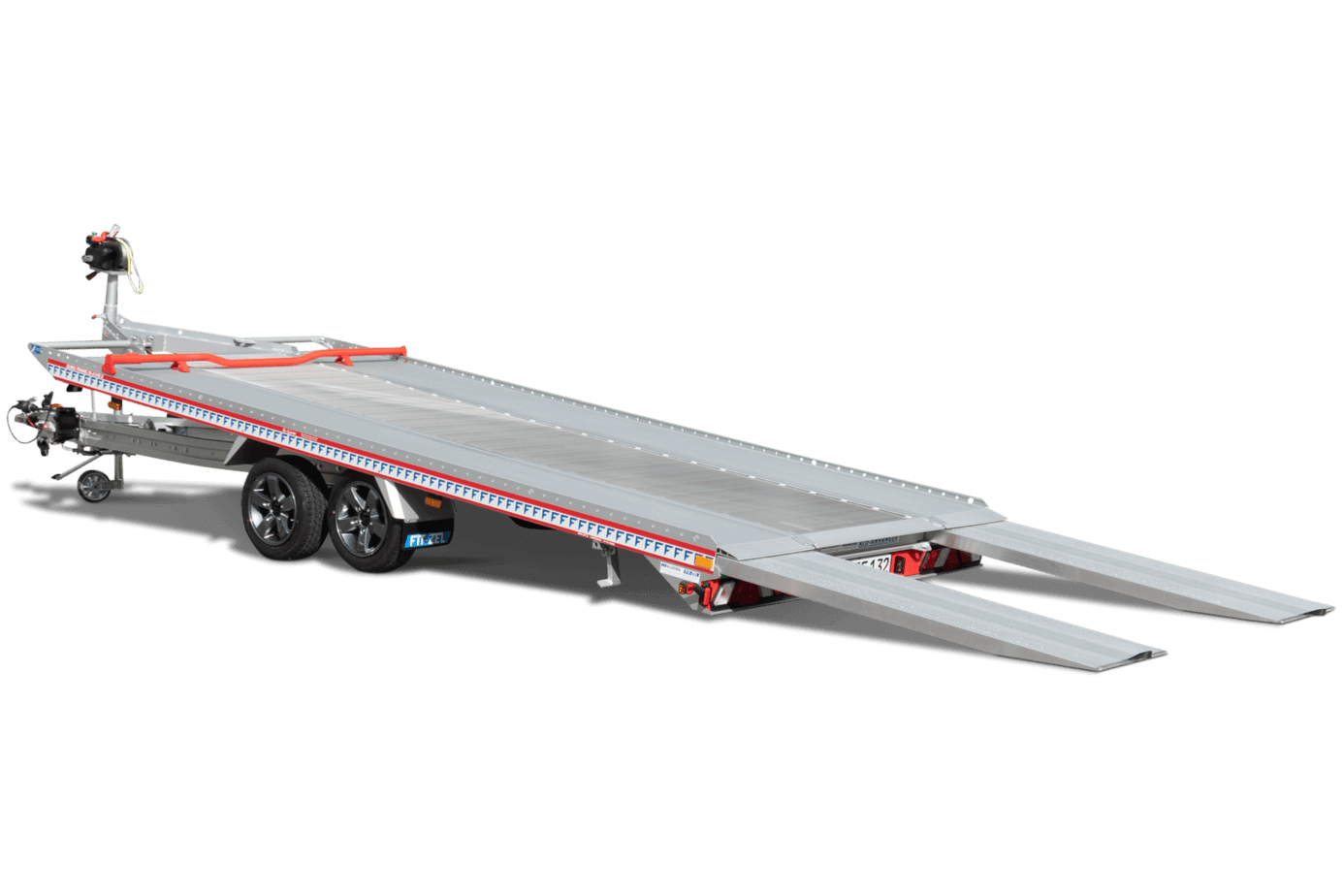

But I have seen pics of a grenadier towing a grenadier on IWT. How is legal, an IWT to tow 3.5T weights at least 890kg. So a grenadier is 2.8T + 0.89T = over the 3.5T vehicle limit, the trailer limit and in some cases over the drivers licence 3.5T limit. (Model dependant but in some cases things are getting close to the limits.)

Are you sure it was an IWT? I've only seen Ineos themselves using this trailer. I think it was discussed, but buried in a general thread maybe, but the trailer was French, lightweight aluminum(?) and when you looked at the specs it just came in under weight:
You're probably right and I can't see IA getting caught out. But in the UK it is something to watch out for as IWT are the biggest manufacture/supplier of trailers. As a rule of thumb, in my flatbed, I know if my load is 2.5T or less then I'm OK to tow.
