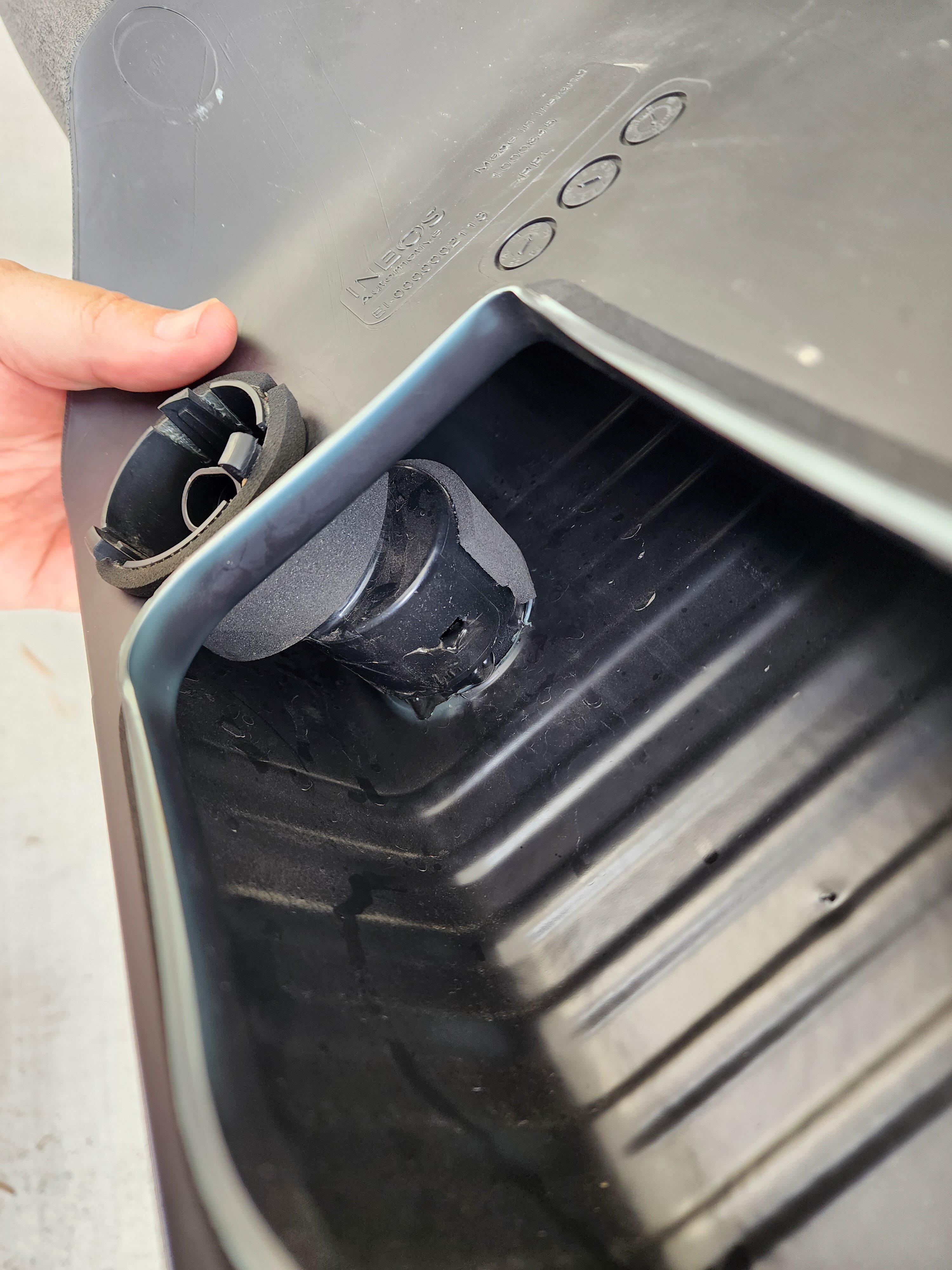

I posted it on FB, so I'll add it here as well... Specifically since the video states that there is no gasket, here's a photo to show the gasket. This is the side of the raised air intake that touches the fender

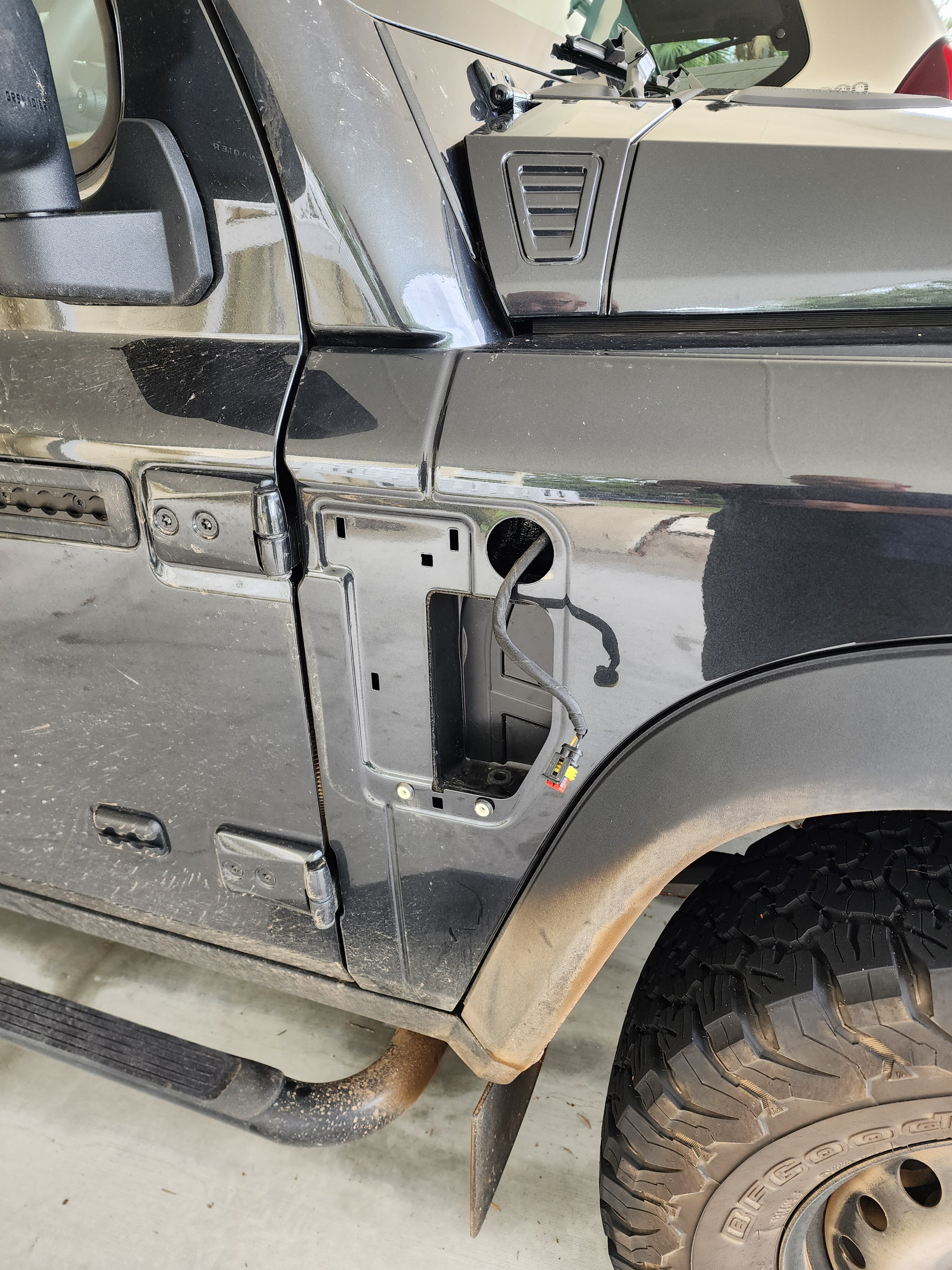

Is it fairly easy to remove the RAI and are factory replacement side vents and A pillar fillers available?
Do you have to cut the wire or is there a connector that can simply disconnect?
Does anyone have the part numbers for a vent cover and A pillar fillers.
Are there any instructions on removal?
Reason I ask is I am likely going to remove my RAI, however would also like the ability to put it back on in the future.

I haven't done it myself (the photo was sent to me); however it isn't a super involved process. From what I've heard it is a bit intricate to get the indicator removed properly from the RAI, but other than that very straightforward. No instructions exist in the wild as of yet, but, if you have a friendly dealer parts department, they should have access to that and should be able to print off a few pages of the repair steps.
The harness in the photo has been cut, but there is absolutely a connector at the turn indicator that can simply be unplugged.
Part numbers should be able to be sourced from a dealer, again, assuming they are willing to put in the leg work to scroll through some pages.
The only "difference" for the RAI vs. the standard fender intake are external, so the swap shouldn't be too terrible. What this means is that the drain that is in the intake tract exists for both vehicles with and without the RAI

I took mine off in 10 minutes. 6 bolts One of the clips had broken that's holds the Australian (ADR) indicator in place. There is a drain inside the car body. There is also a gasket. It is a duetsch plug connection to the light. That's the hardest bit to undo. I'm not expert but it's not a snorkel the way it is.
