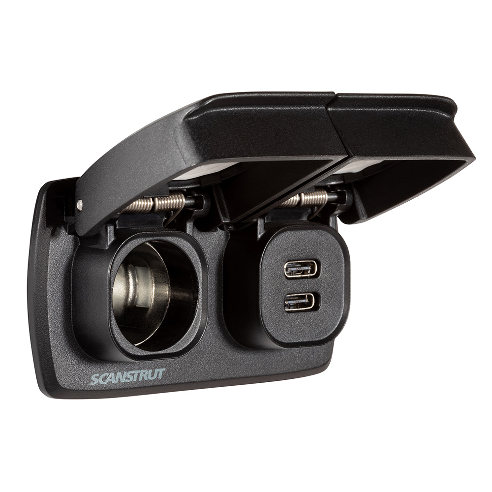

Good point - maybe a marine socket w both 12v and a couple of USB adapters - something like this
