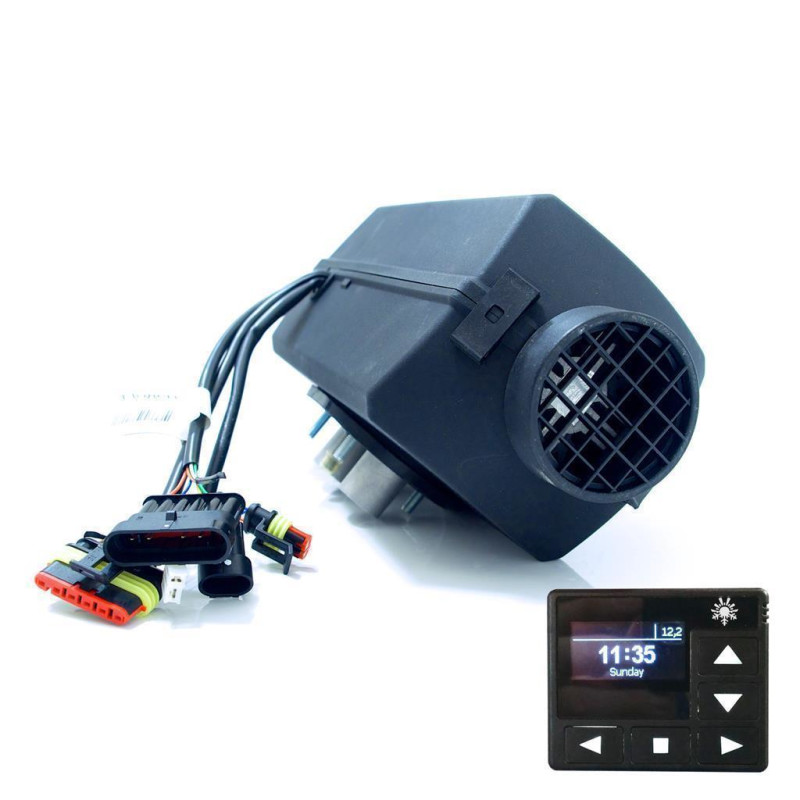

That's way cheaper than the Webasto and Eberspächer devices.
- How long do you have it now?
- How often do you use it?
- Have there been any problems or faults?
II bought it five years ago and built it in by myself. In the winter I use it some days a week. This weekend I drove 800 km Autobahn with the Defender and switched the heater on for some hours as the original heating systems of the Defender is more or less a joke.
Two years ago I fitted a second battery to be fearless using the heating in remoter areas while hunting at night.
It is a well known system which works fine. You find a lot reports on it in the internet. There are special kits for VW T4 and T5 as well as Defender and stand alone systems
