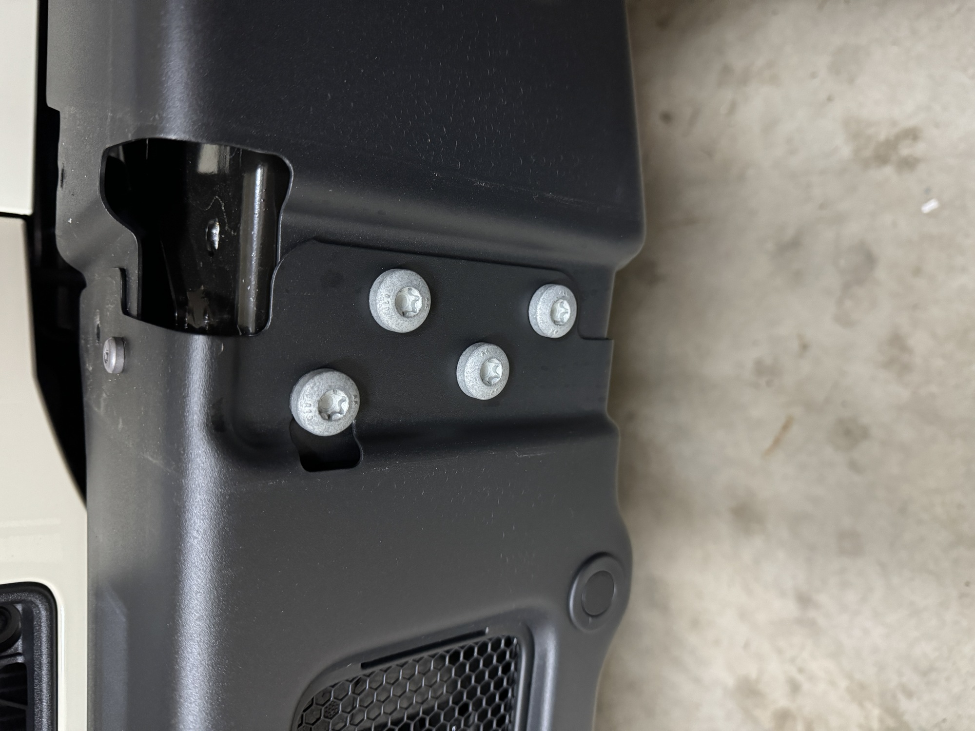

The covers on the NAS bumper are plastic where the roo bar is steel. I guess that might make a difference? Here's a pic of the covers and what's behind 'em.View attachment 7843507View attachment 7843508
Many of the modern car sensors are sensitive to metals and not plastics. That is why so many new vehicles have only plastic bumpers or plastic inserts in their bumpers. So yes it's because the panels are plastic and not metal that they don't cause an issue.
