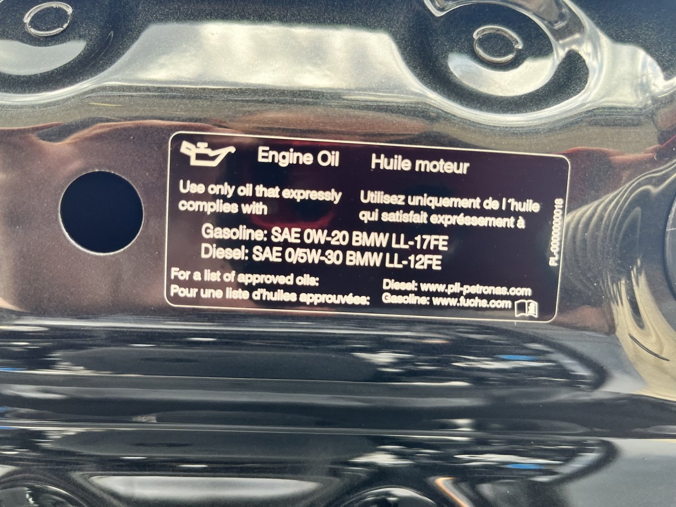

As I say pick up a couple of litres from the dealer when you collect the vehicle till all becomes clearer. They must have stock for carrying out PDI if it needs a top up
I had understood any oil meeting SAE 0W-30 API SN ACEA C2/C3 BMW LL-04 BMW LL-12FE sufficed the diesel Grenadier's needs. I don't believe Petronas is the sole oil provider. I intend using MANNOL, available at a reasonable price on Fleabay .
I certainly won’t be tied to a particular brand as long as it meets the right specifications 👍🏼
