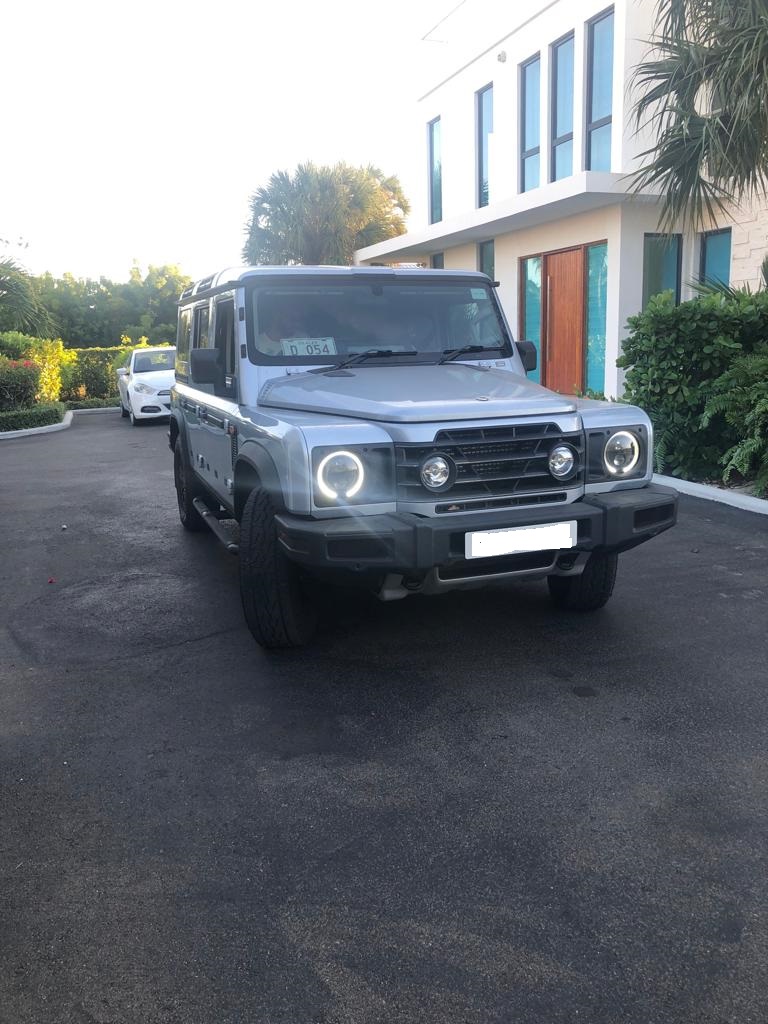

The dealer in UK, still does not have a Diagnostic tool either, we are totaly willing to buy the Factory Diagnostic tool, as I believe this will not be the only Grenadier on island for too long, also you would be amazed which new vehicles are on island without any dealers, as a former Land Rover Dealer we subscribe to TOPIX and JLR EPC have the official Pathfinder and VCM for the rest we all make do with Autel, Launch, Snap-on diagnostics etc. Its a different Life out here:)
