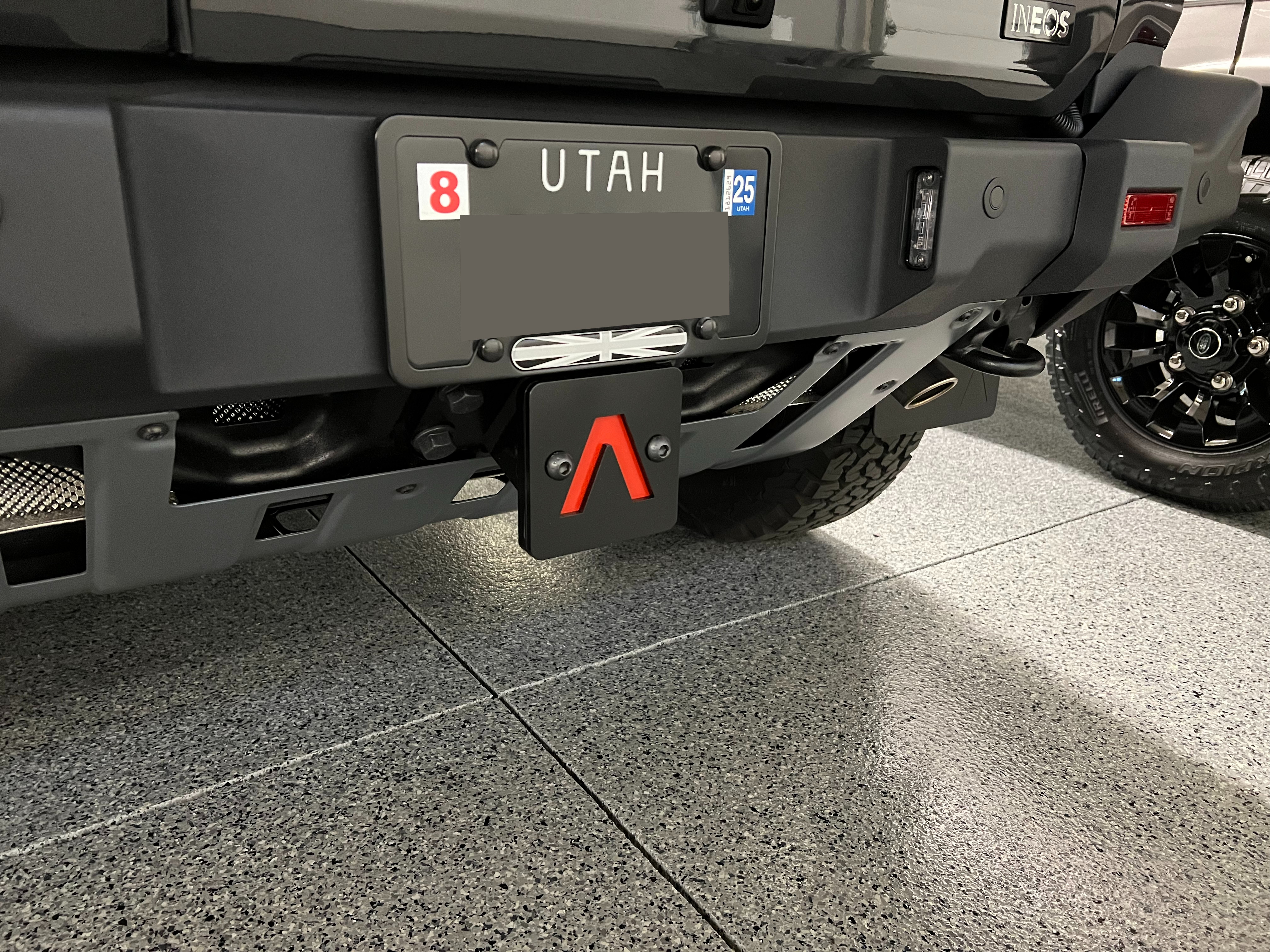

Had some spare time so I fabricated a cover plate for the receiver hitch as I always felt it looked a little unfinished when not in use. Working on a version with a red lambda and will post pictures when I have it finished. Just a fun little project for the Grenny.
Finished version 2.0 with the red lambda… I think it turned out not too bad for a beginner see pictures below:

Looks great and I'd buy it in a heartbeat! One stupid question....what size screws did you use to attach to the tow plate? I can't figure it out.
There are six threaded holes on the stock hitch plate. The top four are M12 x 1.75 and I believe the bottom two are M16 x 2.0. I used the middle two for attaching the cover and the bolt length used was 30mm. Note that the threaded holes on the hitch will not allow the bolt to thread all the way through (at least on my vehicle it didn't) so you'll have to be quite specific on the bolt length for whatever you are attaching to the hitch.
