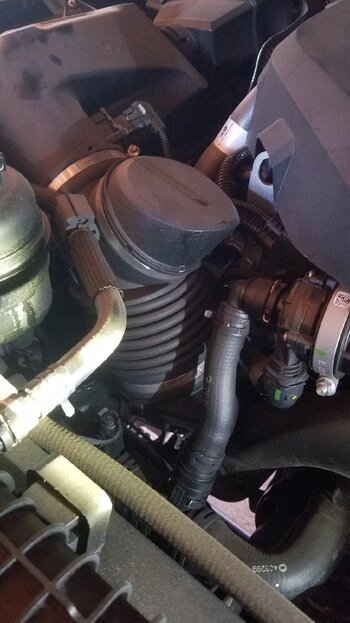

a curiosity about the air filter: what is this appendix for?
Most likely a resonance/expansion chamber to help tune impulses in the intake tract to help quiet it down or possibly eliminate unwanted turbulence of the airflow to help the air move more smoothly through the intake increasing efficiency slightly.
