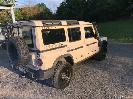

I've seen some adverts for 16" sprinter wheels with the grenadier as a fit. Um, do 16's fit the Gren?
I once saw a few pictures somewhere of a Grenadier on 16’ Dotz Dakar with 255/85R16 tyres. But I can't remember where that was. It should fit, albeit tightly.
I looked at mine once, I think steels in 16 would just about fit, alloys can be a bit thicker… It would be very close to the callipers. And you wouldn’t be able to put wheel weights on the inside.
