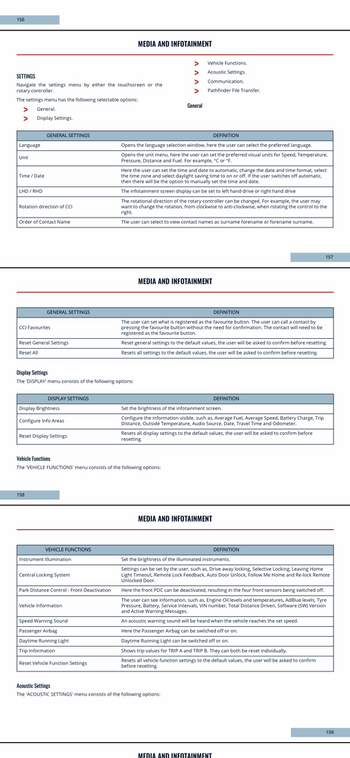

No it’s gone continental, flipped across to left hand side , I’m in uk driving right hand side, what’s KM/h all about
Have you looked at the settings? You can switch between left & right hand drive. I know you didn’t intentionally change anything but put it down to electrical gremlins.
Settings - how do I access these ?

I am currently away from home but I read it in the manual. Will see if I can find it again.
