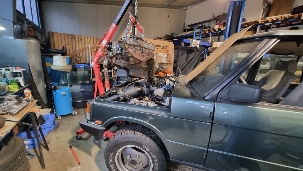

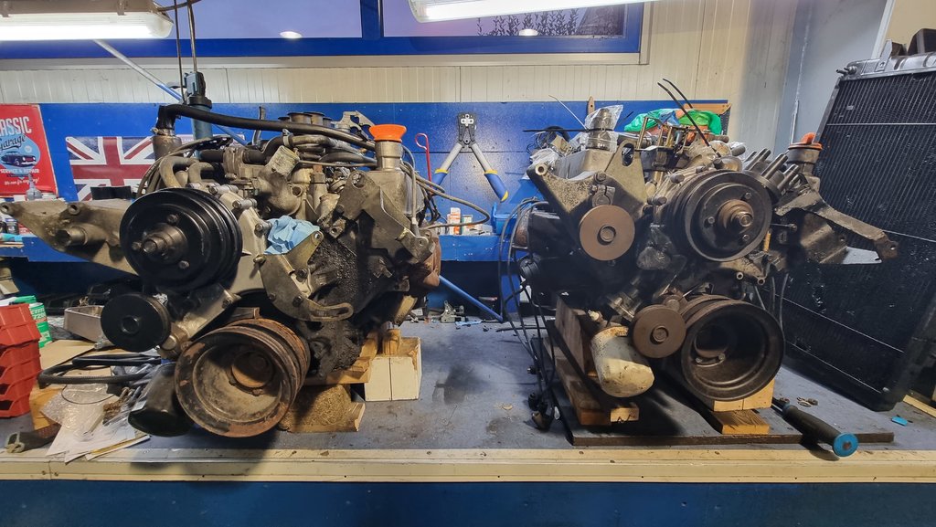

AWo
1:56 PM
Feb 28, 2023
1,090
2,071
Finally I got engine #2 out. Now they are next to eacj ozther as I need to exchange a few parts, like the heating water pipes. Then the 1986 3.5 efi engine comes into the 1987 Range.
