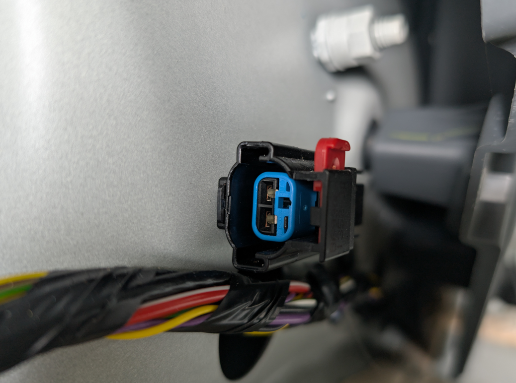

Prepping the rear cargo area so the Auto Electrician can install 3 in one power outlet where the lighter socket is located and noticed there are these 2 connectors with nothing connected.
Does anyone know what these 2 connectors are for ?????

No. 2 plug does it terminate the twisted pair of wires? Twisted pairs of wires in a harness are generally for data transfer network like CAN BUS. The cap may contain a terminating resistor for that circuit.
Auto sparky will lead you in the right direction when they have a look.

Are you petrol or diesel? The only thing that springs to mind ( if petrol) is adblue sensoring

I "thought" there was a reference elsewhere that the connectors are for the inverter which was supposed to be standard equipment.... then wasn't ( like workshop manuals😂).
I think you’re right. I’ve seen elsewhere that they’re some type of control wires for the factory inverter.
Number 1 is definitely the canbus controller for the optional factory inverter.
My 23MY doesn't have number 2 so can't help.

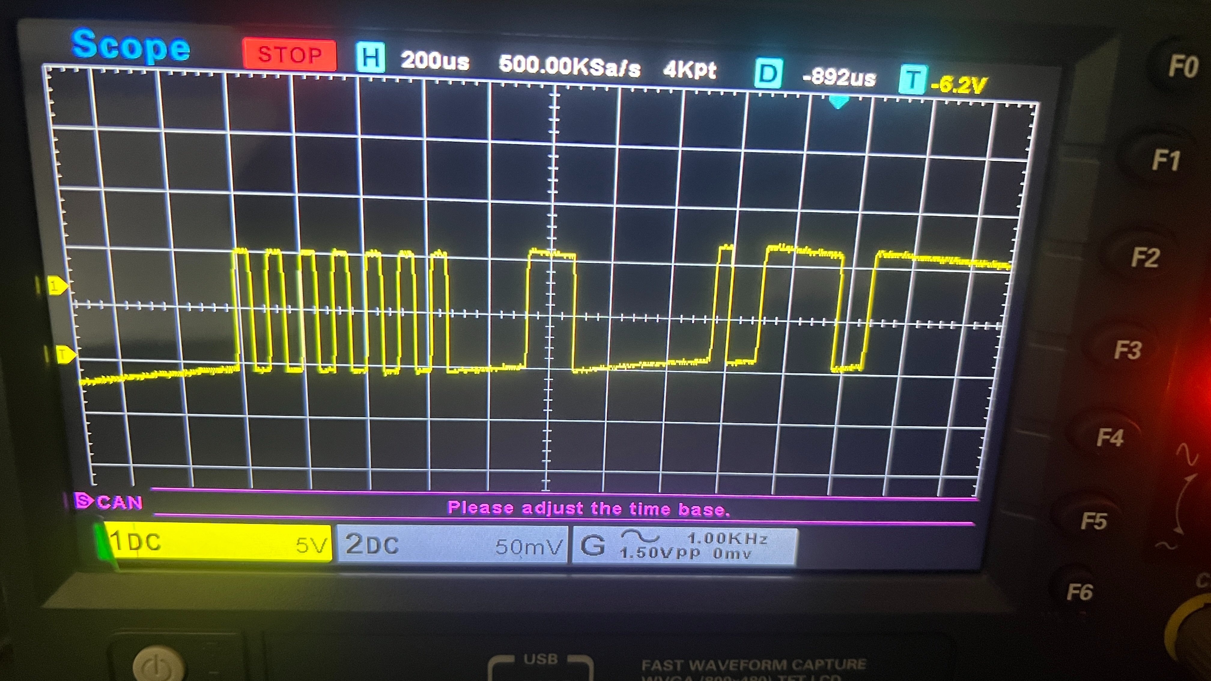

I put an oscilloscope onto the number 1 connector. The waveform indicates strongly that this is a 19.2Kbaud serial style interface. Voltages are too high for CAN and the speed is to slow. But @landmannnn is likely correct, it is used to control the inverter. I am now hunting for a place to tap into the canbus.
