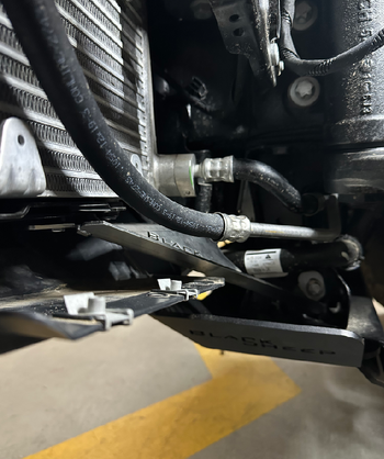

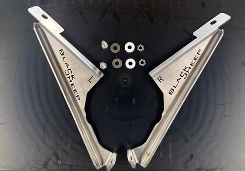

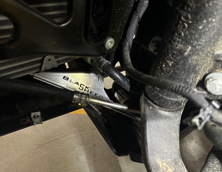

Was at the dealer today to get a bit of work done. Spotted a Gren there with it's plastic fron bumper off giving a much clearer view of the lower rads on either side of the vehicle.
As we know the UK (euro) spec rads are not supported by means of the OEM strut and a couple of forum members have suffered one of them coming loose out of the top bracket when driving on corrugated roads in Africa.
The problem is the vertical vibrations meaning that the rads can jump out of their rubber grommeted pins of the top retaining bracket.

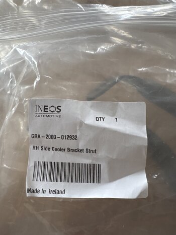

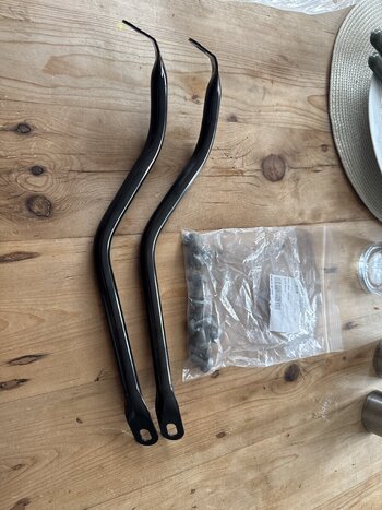

@Logsplitter managed to jury rig his until got to a dealer and had the lower struts pinched from a donor ROW spec vehicle. His struts appear to have been attached to the lower part of the large steel front member/bumper which the UK plastic bumper attached to. A bolt or nut was welded on. Whereas the ROW models have a different lower bracket with a fixing that the strut bolts to, perhaps a captive nut.
So for those that are interested the solution is to try and get both the struts and the lower brackets from a UK dealer, whether this is possible I don't know. I am still awaiting for a reply from Adventure Automotive, Oxford. It is not known whether the lower brackets of the rads will fit on to our plastic bumper models, I am willing to give it a whirl. If not then we weld a fixing on a la Logsplitter's mod.
There was a very valuable post from @CountyV8 with CAD screenshot of the Ineos parts and prices on the 'Stuck In Namibia' post. Will try and attach here.
Note that the rads left and right differ in size and the top brackets are different, whether this is the same for the lower brackets and/or strut I'm not certain.
I for one would like this mod asap.

Very informative photos @ECrider 👍🏼. I’ve used your images and drawn lines in red where I wrapped the fence wire around to clamp the top and bottom rad brackets together which lasted for thousands of kilometres. Note that I could not work out how to take the plastic outer bumper off so may have done things differently had I been able to work that out and so see exactly how the rad brackets were fitted.
The photos with green marks around is where I would consider putting a stainless steel cable tie around or made up bracket to encapsulate the rad in its brackets. Should ever have an issue again.
Very informative photos @ECrider 👍🏼. I’ve used your images and drawn lines in red where I wrapped the fence wire around to clamp the top and bottom rad brackets together which lasted for thousands of kilometres. Note that I could not work out how to take the plastic outer bumper off so may have done things differently had I been able to work that out and so see exactly how the rad brackets were fitted. View attachment 7890880View attachment 7890881View attachment 7890882View attachment 7890883View attachment 7890884
Thanks for that, I was wondering how you rigged up the field repair 👍. Good for is to know.
