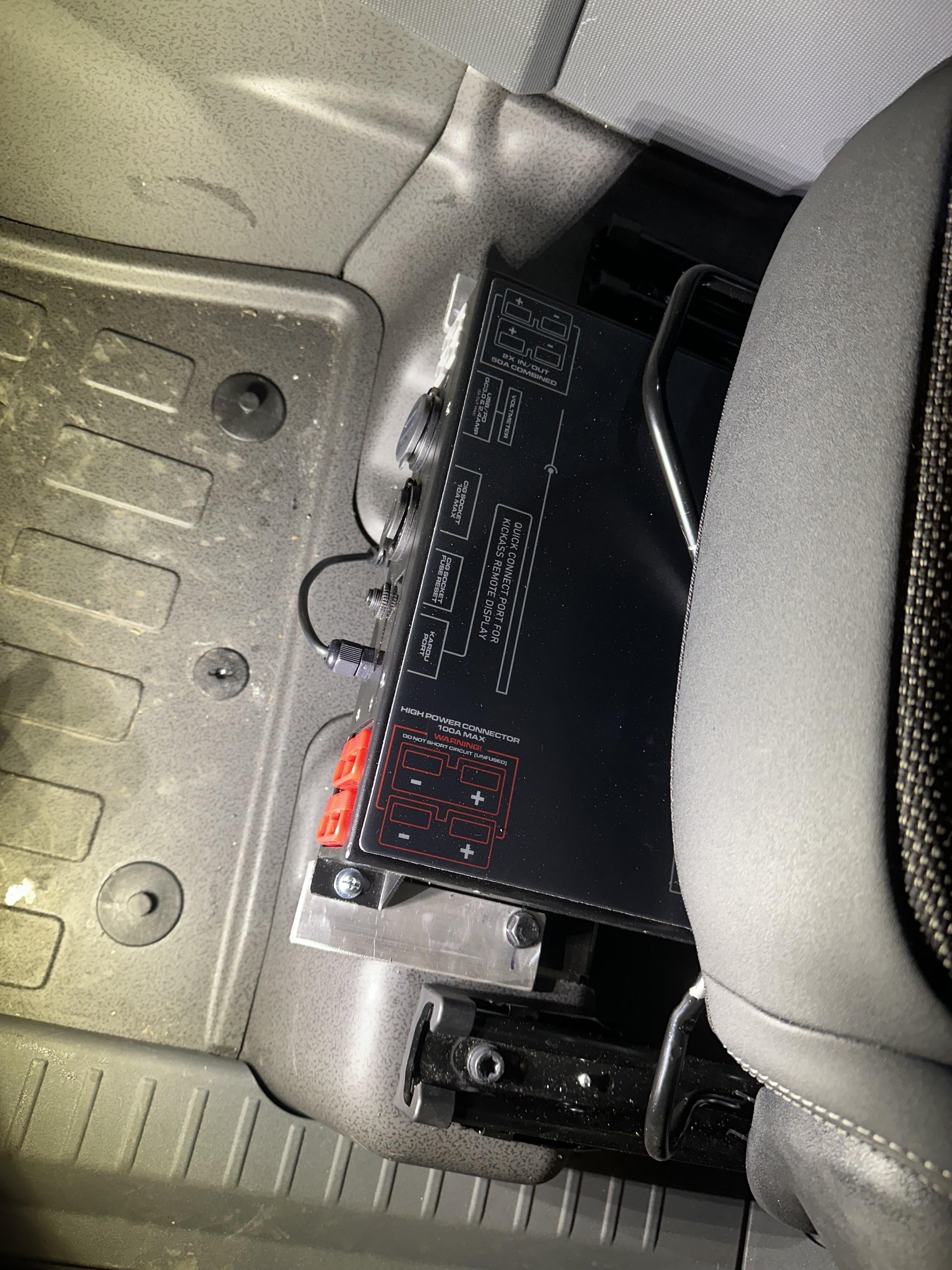

It’s been awhile since there has been any updates to the build but now things are starting to happen. I removed the factory aux battery and CTEK plus a bunch of other wiring and components (400w inverter, NATO Albright Relay) that will not be part of the final build.
Then a REDARC 150ah battery, and a BCDC Alpha 50 was installed with Anand doing most of the work and me watching and learning…..Thank You Anand!

The Silenus roof conversion is happening this week at OK4WD. The plan is to have the new lights and outlets that come with the conversion to be powered by the Redarc 150ah house battery. So today, Anand and I installed a Blue Sea Systems 5026 ST Blade Fuse Block with 12 circuits. The original fitment instructions calls for the power to be tied into the INT 1, 10a circuit but that would mean that it would be drawing from the starter battery.
We found a convenient spot right in front of the BCDC Alpha 50.
Again, many thanks go out to Anand for his insight, craftsmanship, and tireless help!
