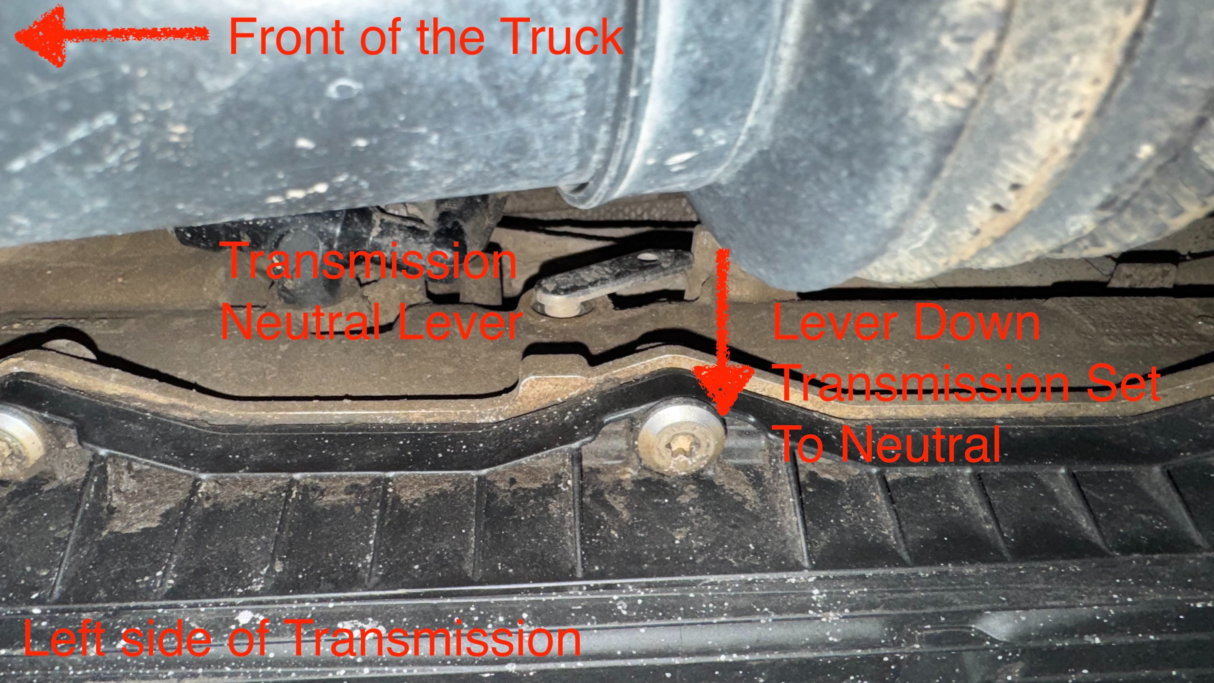

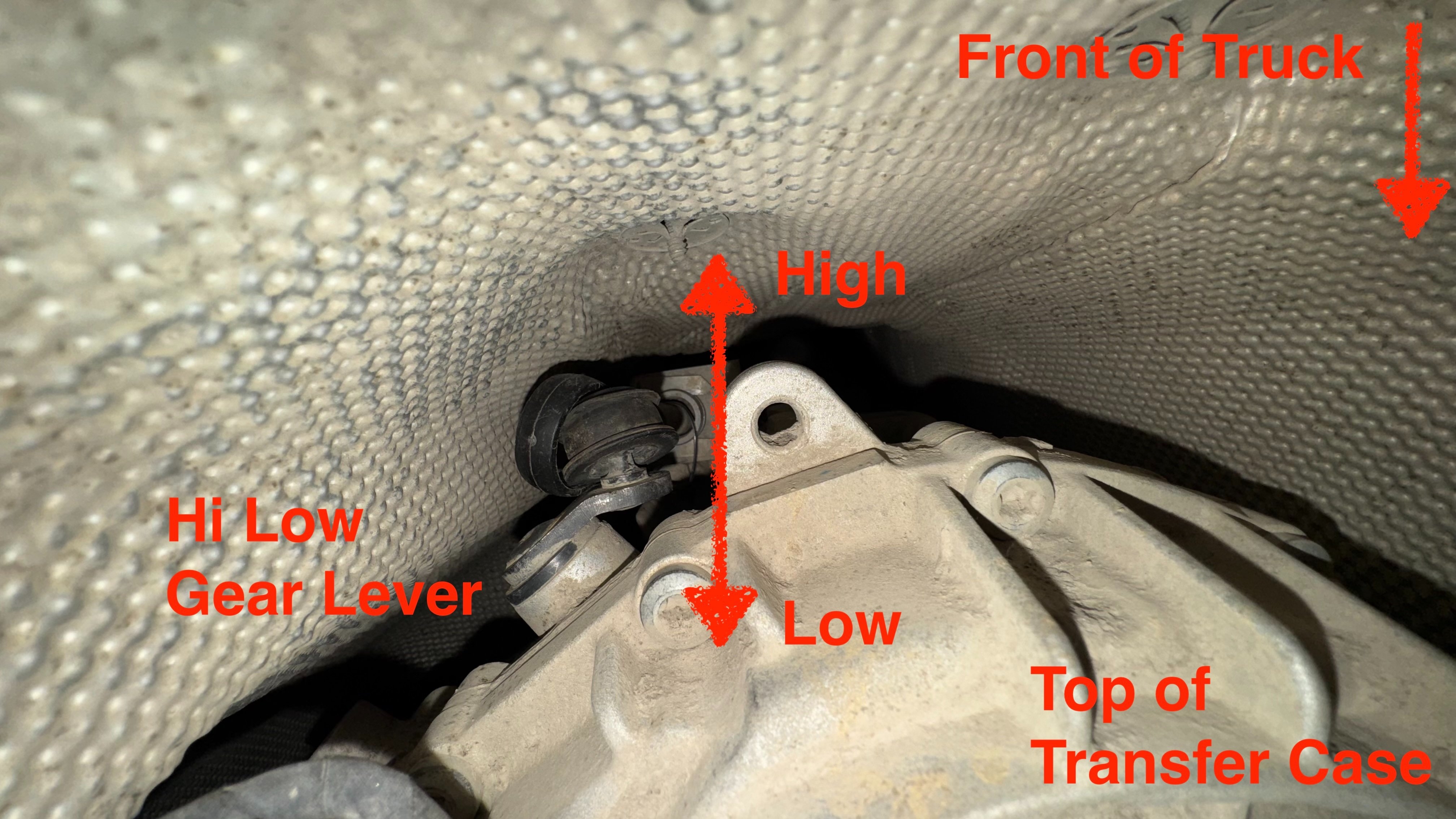

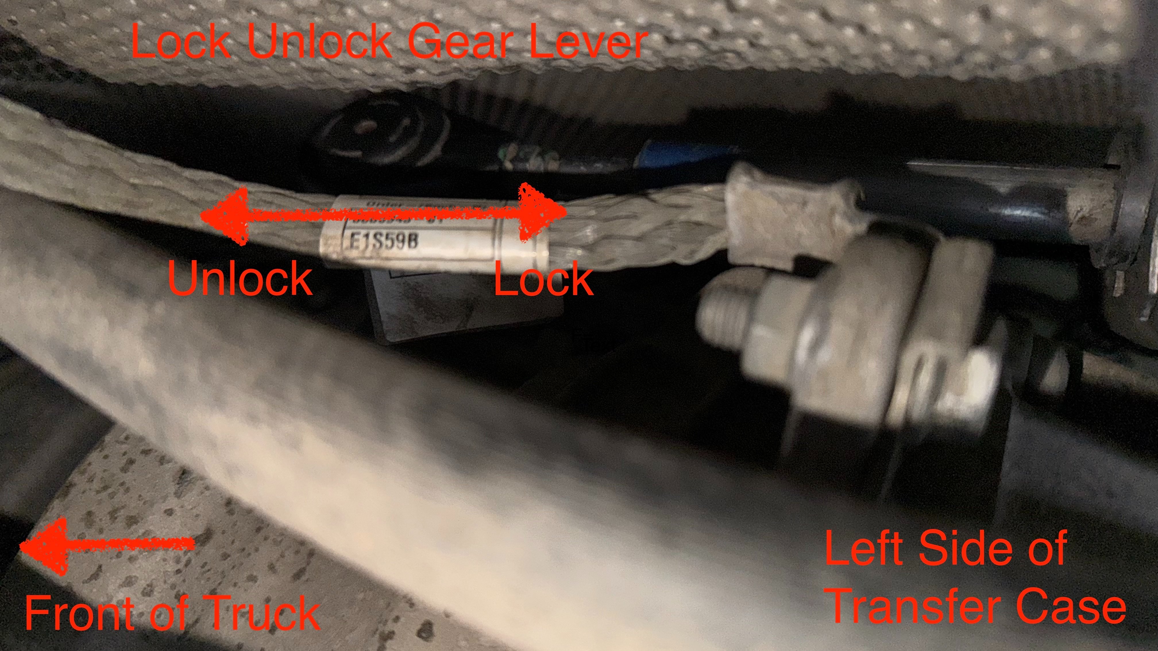

Thanks for the feedback. I'm tossing around some candidate scenarios for a write up of roadside recovery actions for a new section of @Rok_Dr's guide. The type of stuff that comes up in the SOS section so it's at hand if you have a copy of the guide. I want to say this one is too obscure and not worth prepping for but it's not the first cable to break so it might be worth a mention. Cheers.

@Clark Kent Let me know if you need the originals
Thanks @samnt650.

The red callouts will disappear in a printed copy. If you wouldn't mind posting the originals then @Rok_Dr can add callouts using your markup as a guide.
Please confirm the direction of the range selector lever on the transfer case: Forward is High range and rear is Low range? That's consistent with your 19 Jan post.
Posting the original here...
For the High Low gear lever >> move toward the front = High toward the rear = Low
For the Transfer Lock >> move toward the front = Unlock / open toward the rear = Lock
>> CORRECTION >> Lever toward front LOCK. Lever toward rear UNLOCK
For the transmission neutral lever >> move toward the ground, and find a way to hold it there = Neutral

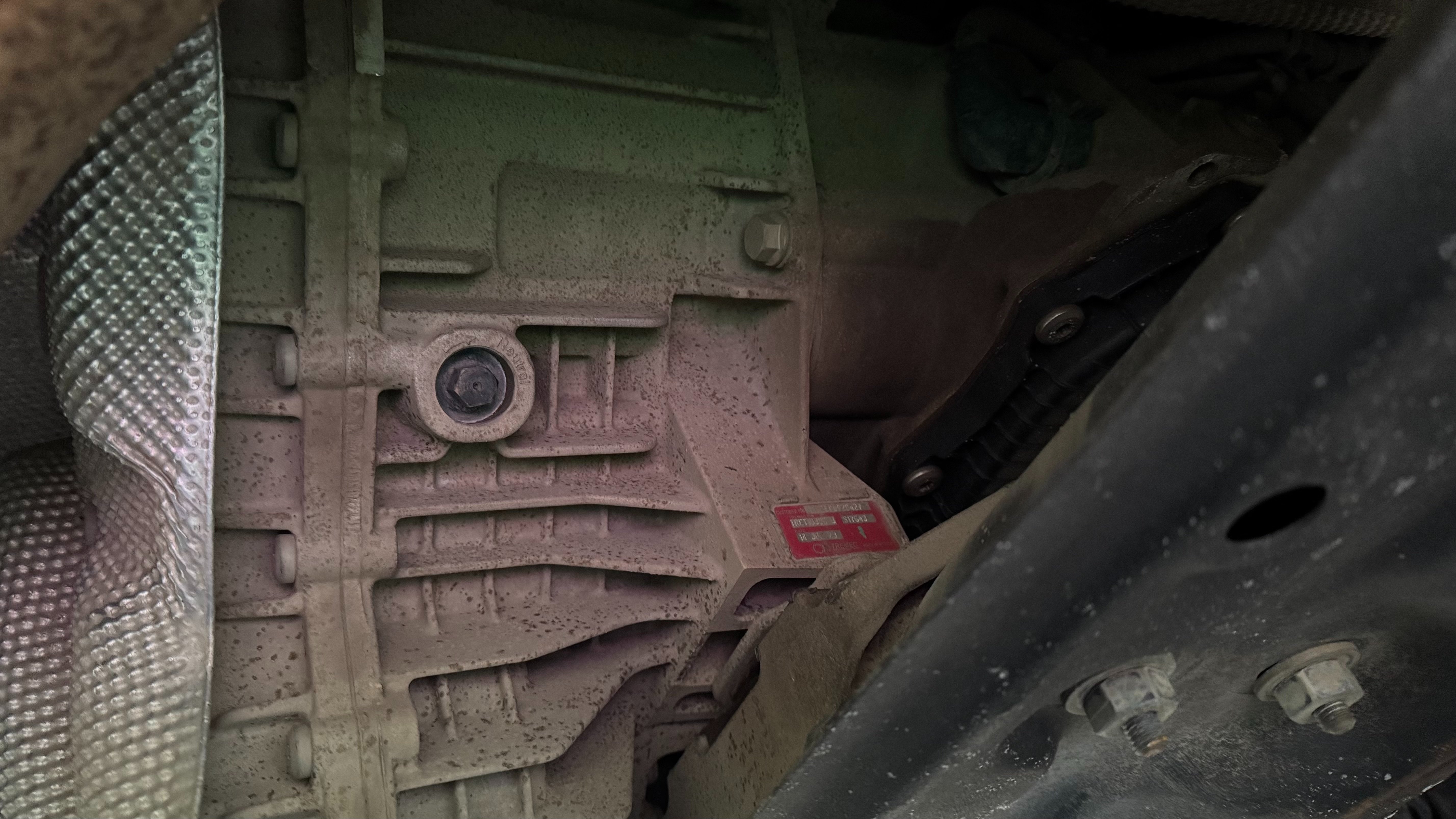

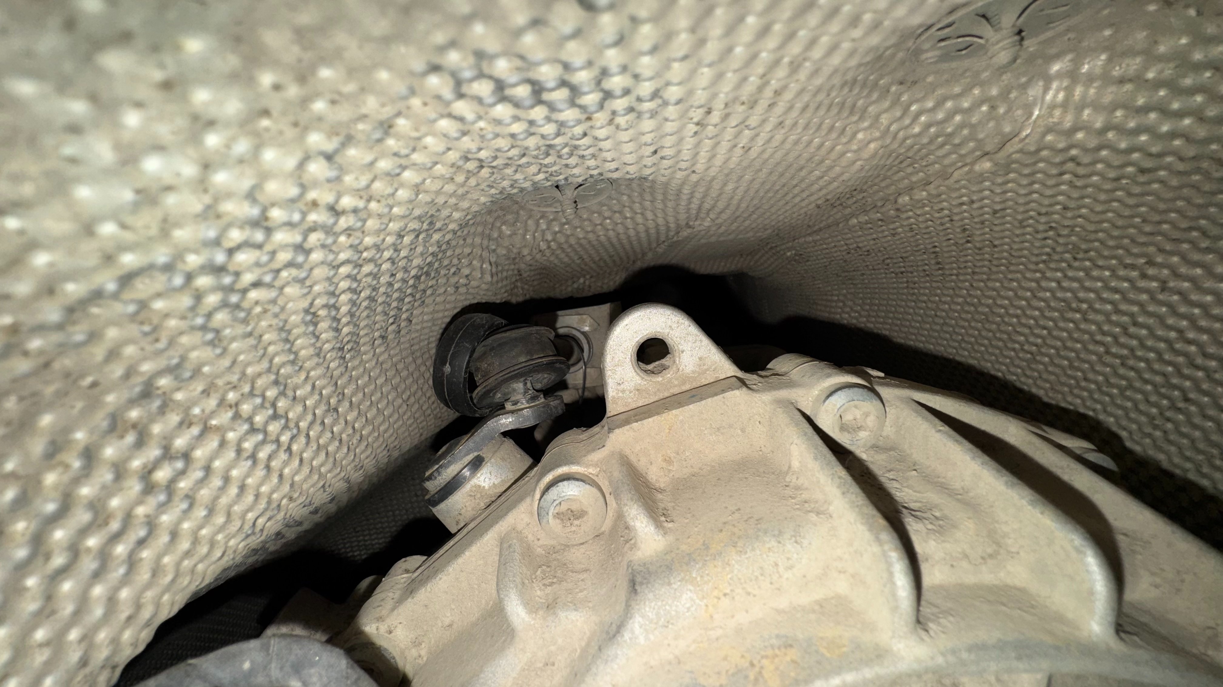

Photo of the transfer case out of the truck. The transfer case is resting on the neutral bolt side.
Photo is oriented as top of photo point toward front of truck...

Good pics thanks @samnt650
Pic 1 (img 7543) shows the centre diff lock lever at the bottom near the forward driveshaft flange and the hi-lo range lever at the top. Is that correct?

Pic 1 / img 7543 - You are correct. Left of pic is front of the truck.
