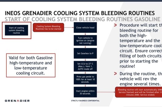

I was going through the process of bleeding my HVAC coolant. I followed all of the instructions precisely. When I depress the accelerator for 10 seconds, the car enters Service Mode. As soon as I start the engine it says Service Mode Cancelled. This is a cold start so temps are cold. I have tied multiple times. Any suggestions?

I'm not sure what procedure you're following. This is the one I have bookmarked.
Hood/Bonnet position is different for gas versus diesel just FYI.

Hi, this procedure for gasoline engines. After holding the gas pedal ‘service started’ appears, but as soon as I start the car with the brake pedal pressed, I got a notification of “service cancelled”.

Brake pedal pressed? That's not in the procedure.

Thanks for all your help, turns out that I should have paid more attention to the instructions. Apparently the procedure would not start with the bonnet open - honestly I’m surprised this has any bearing on it. I’ve managed to initiate it now, I’ll see how it goes this week and if there is an improvement. I do have a small amount of residue around the seam on the high pressure tank but this is above the level of the coolant. I’ll keep an eye on it and take it in to the dealer if the level drops.
