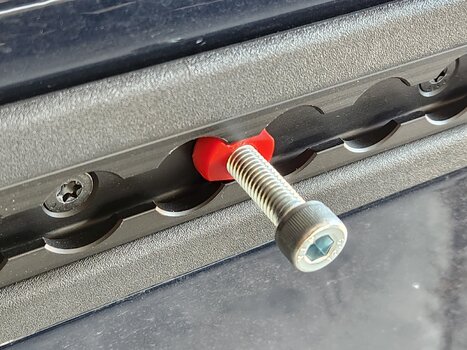

Latest CAD model and a 3d-printed fitment prototype are shown below.
The M8 nut enters any clearance hole along the rail, then slides into a holding position. It "finds" its ideal position when rotated clockwise during tightening, which aids in locating an attachment.
