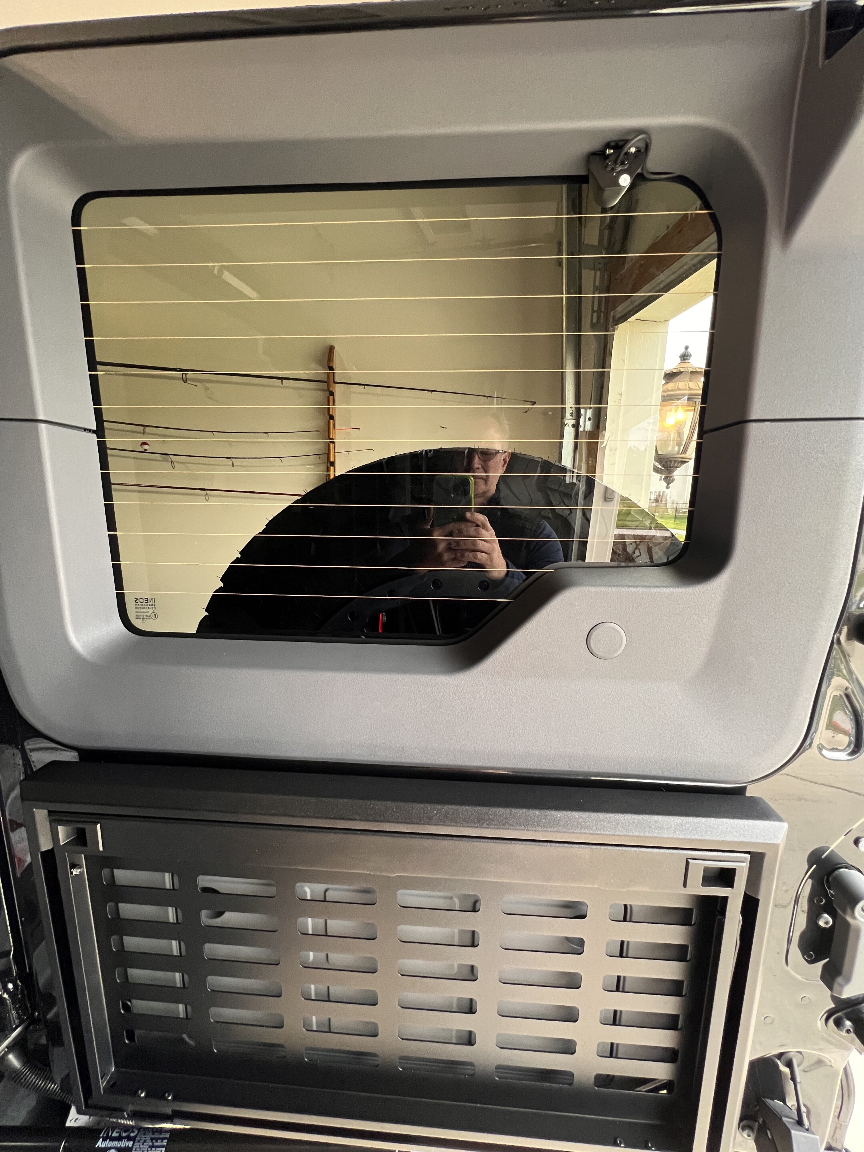

I had a specialty audio shop install my rear camera, Wolfbox and they ran the cables in the roof liner, and followed the same path as the wires for the rear wiper. Not sure how they did it, but audio shops can do it!!
