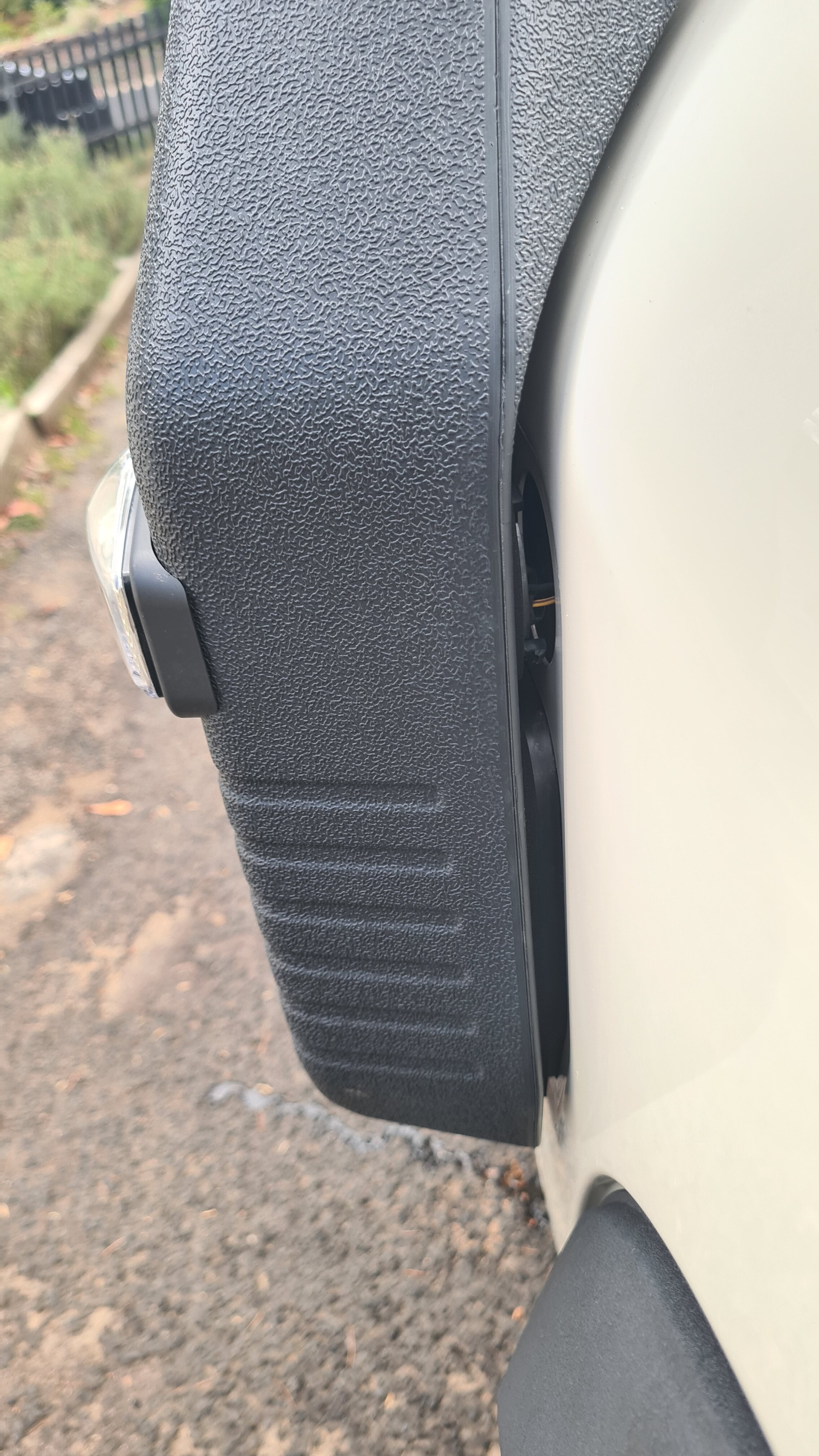

I had a plastic "knocking" sound on the highway... Sounded like a loose wire or cable banging around in the front right door or wheel area. On inspection, the raised air intake has separated from the body. The lower and A pillar mounting bolts are all still tight and the intake has never been hit or knocked by anything.
