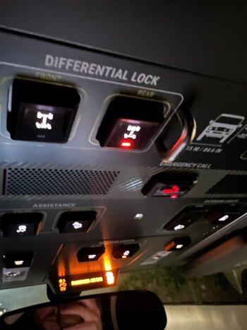

Hi Guys, we got stuck in Greece on the beach. Luckily we got out but the rear difflock won’t disengage. There is an error saying “Button of the rear difflock is defect”
The rear difflock warning light is flashing red. The button is also flashing (orange)
I don’t think it’s safe to drive on-road now.
Any suggestions what I can do to disengage the rear difflock?

Hope you get this sorted.
Have you tried to disengage the centre diff? I think that will knock the rear and front locks off as well.
Also, if the transmission is wound up a bit tight, have you tried to reverse a little. That always used to help in my G Wagen.
Good Luck

When I only had my vehicle for a few days, I also tried out the differential locks. I also had red warning lights. I unlocked the centre differential lock. This also released the front and rear locks. I drove a few metres forwards and backwards. The lights in the switches are flashing. Then switched off the car. Switched off the ignition and waited 10 minutes. After switching the ignition on again and starting the engine, all the indicators went out. I wish you every success.

Thank you @Highwayman and @rovie for the quick reply. Turing off and wait 10 min. helped. The red flashing have disappeared and the error also. But the rear diff lock is still engaged. I’m now in high and center diff off and driving forward and backward for a few meters that I can drive straight ahead. To drive longer or faster I have to make a turn.
Do you think this will cause major problems? The road is asphalt

It may not be locked, it's probably more likely the sensor is malfunctioning. If you try turning you should be able to feel if it's locked. It also senses whether it's locked or not by comparing the wheel speed sensors of each side. So imo, try turning a little on pavement and see what happens

Sorry it’s still causing problems.
Can you safely jack up one of the rear wheels where you are? If you can, then you can confirm to yourself that the diff lock is definitely engaged on the rear. If you jack up one rear wheel and cannot rotate it (with the handbrake off), the the diff lock is engaged. If it will rotate, then the diff lock is not engaged and you have an electrical issue.
Keep us posted

I managed to disable the rear difflock! I drove backwards into the sand and made a right-angled turn backwards. And suddenly it came off.
Thank you so much guys for the help! As far as I'm concerned, this thread can be closed.

Was it blinking or solid when it seems to still have been engaged.
There is a known "Feature" that even if you push the button to disengage it, it will keep blinking until the sensor measure a difference between the two tires and then the light goes off (mostly once you take a turn).
Physically it was stated the moment you push the button the locker disengage within seconds (Light turns from blinking to off).
See video from Robert Pepper:
View: https://youtu.be/KTgupbbRfog?t=831

During and after the red-flashing light / “Button rear difflock deffect” problem the button was flashing orange.
So I think you’re right, it just needed a turn for the sensor to measure but I had too little confidence because of the red-flashing light.
