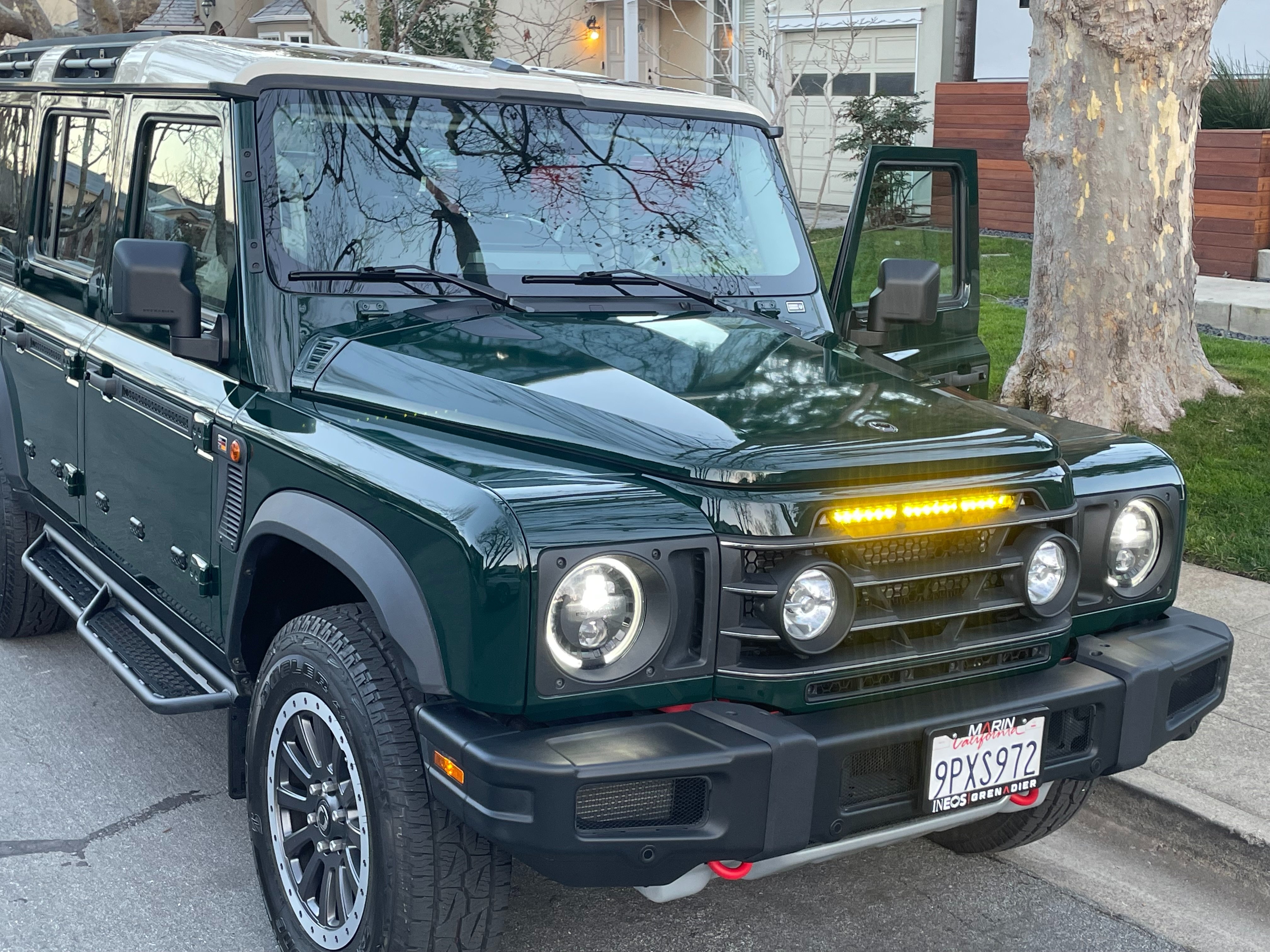

Just wanted to share some images of my installed Owl Outdoor Hidden Light Bar
I had my local auto restoration expert install this for me and he said other than some difficutly finding the wiring for the Aux 1 switch the install was simple and straighforward and all of the parts supplied by Owl were perfect.
The light bar is like a work of art and the wiring harness and swithces seemed first rate.
Owl was easy to work with and i received my light bar about 1 week after I placed the order
the install videas definatley helped my installer
sorry the pics aren't a litte better ..i was just too excited to share them

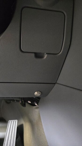

Look at the Triple R lights website for the wiring diagram. I set my customers up with this switch down low so they can rotate through the modes while driving. Its activated on by Ext 1. The momentary ground can be run through the firewall where I take the wheel well out to access. It's actually a longer process but comes out killer.
