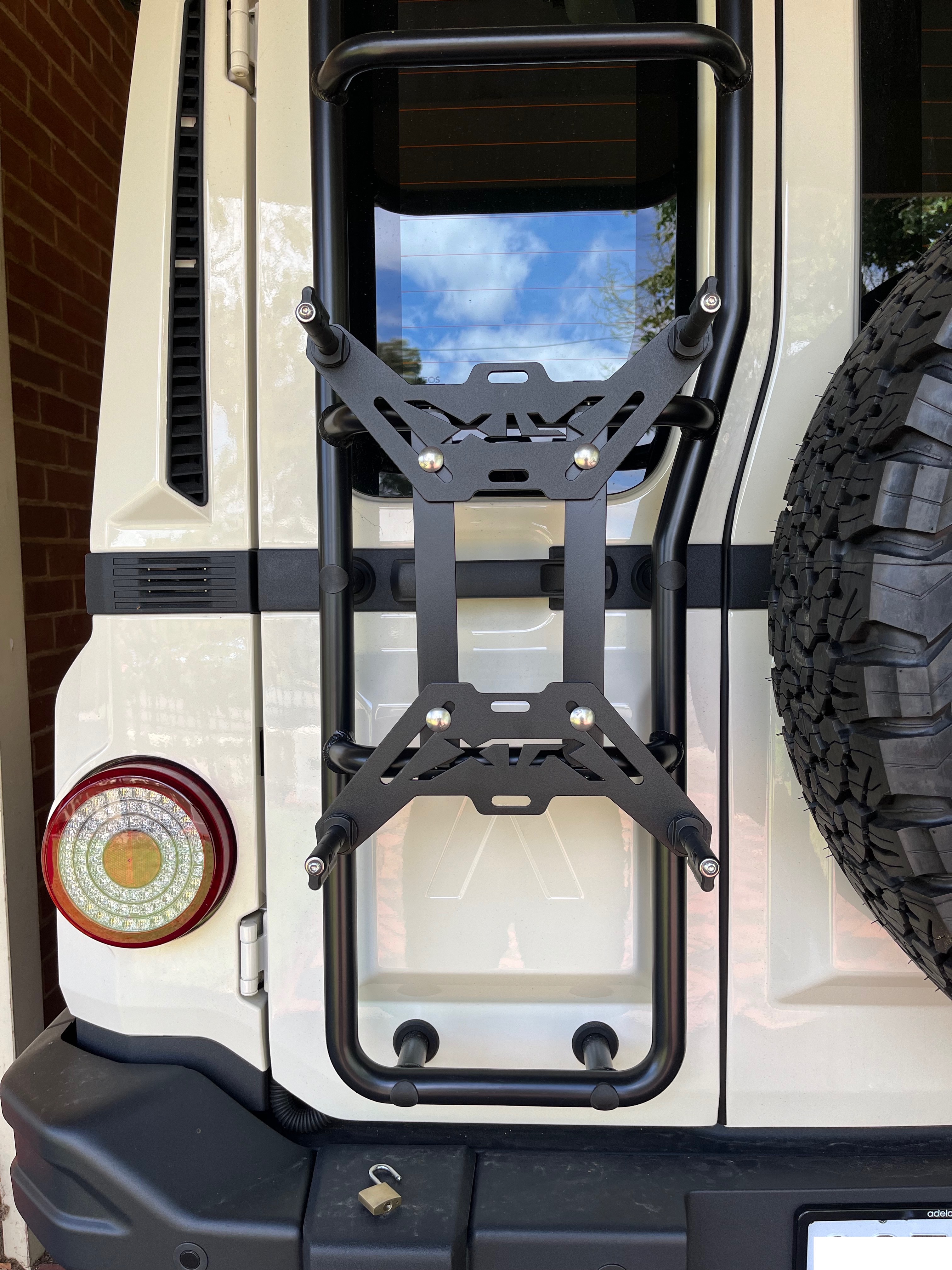

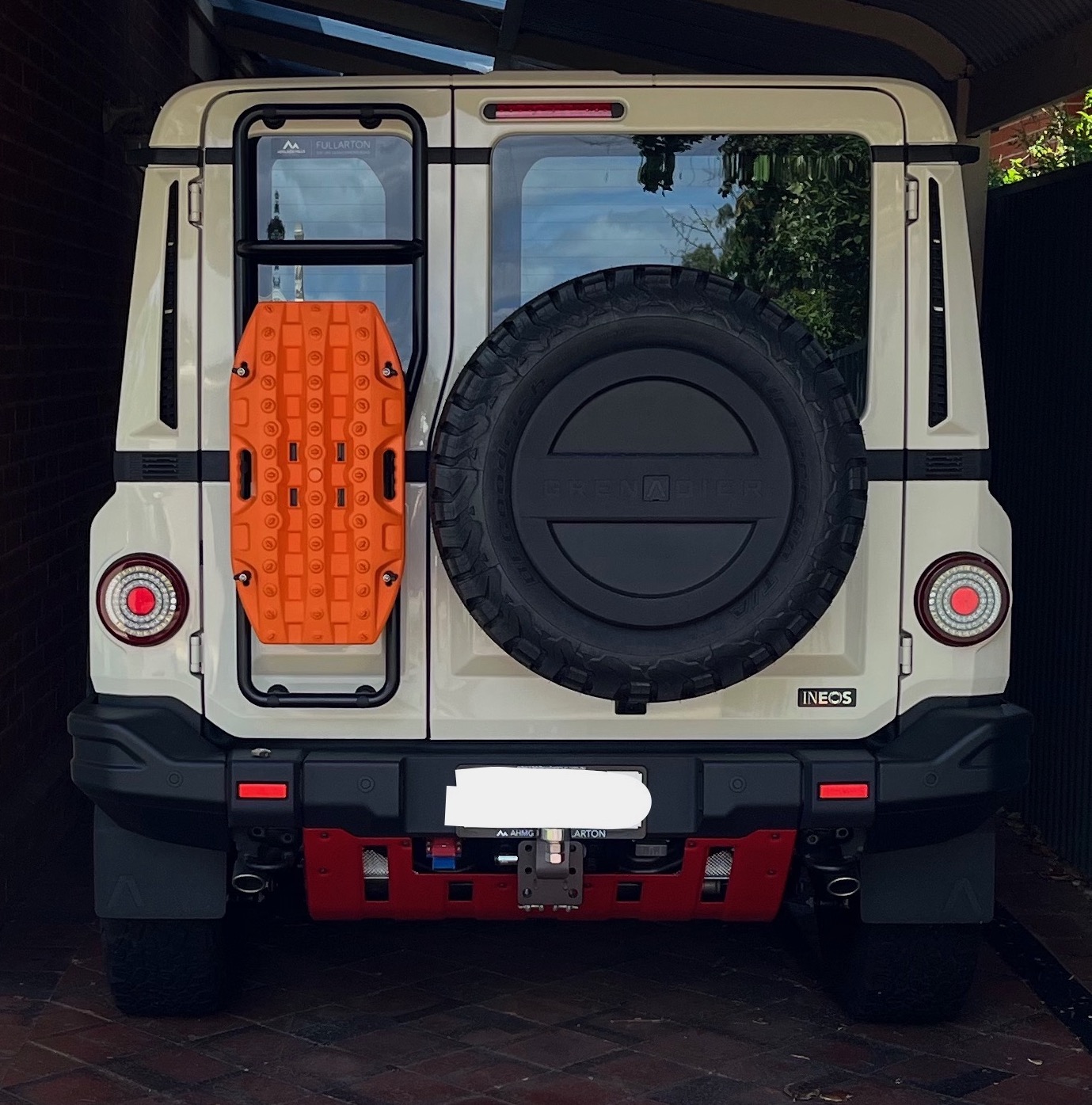

I mounted two XTR Maxtrax-mini specific mounting brackets onto the rear ladder using four clamps, strengthened with two pieces of 30x3mm flat steel bar. Very rigid, lockable and still allows plenty of access to the rear door handle. I chose the Maxtrax Jack-base and mini recovery boards (rather than their full-size cousins) to minimise the impact on the already pretty limited vision through the rear window.

Like the look, but 2 issues.
It’s going to make it a pain to access the door button and handle, I tried mounting mine there and decided I couldn’t live with it, and I am skeptical that mini MaxTrax will be very useful for a vehicle as big and heavy as a a Grenadier

Mini Maxtrax can be joined together to make a recovery track that is as long as one Maxtrax Mk II. So four of these Mini’s are equivalent to two MkII Maxtrax boards. I’ve successfully recovered our 2.9 Tonne VW Amarok using mini Maxtrax joined together in the past. I’d prefer the longer boards but I can’t fit a roof rack because of the underground carparks I have to use!

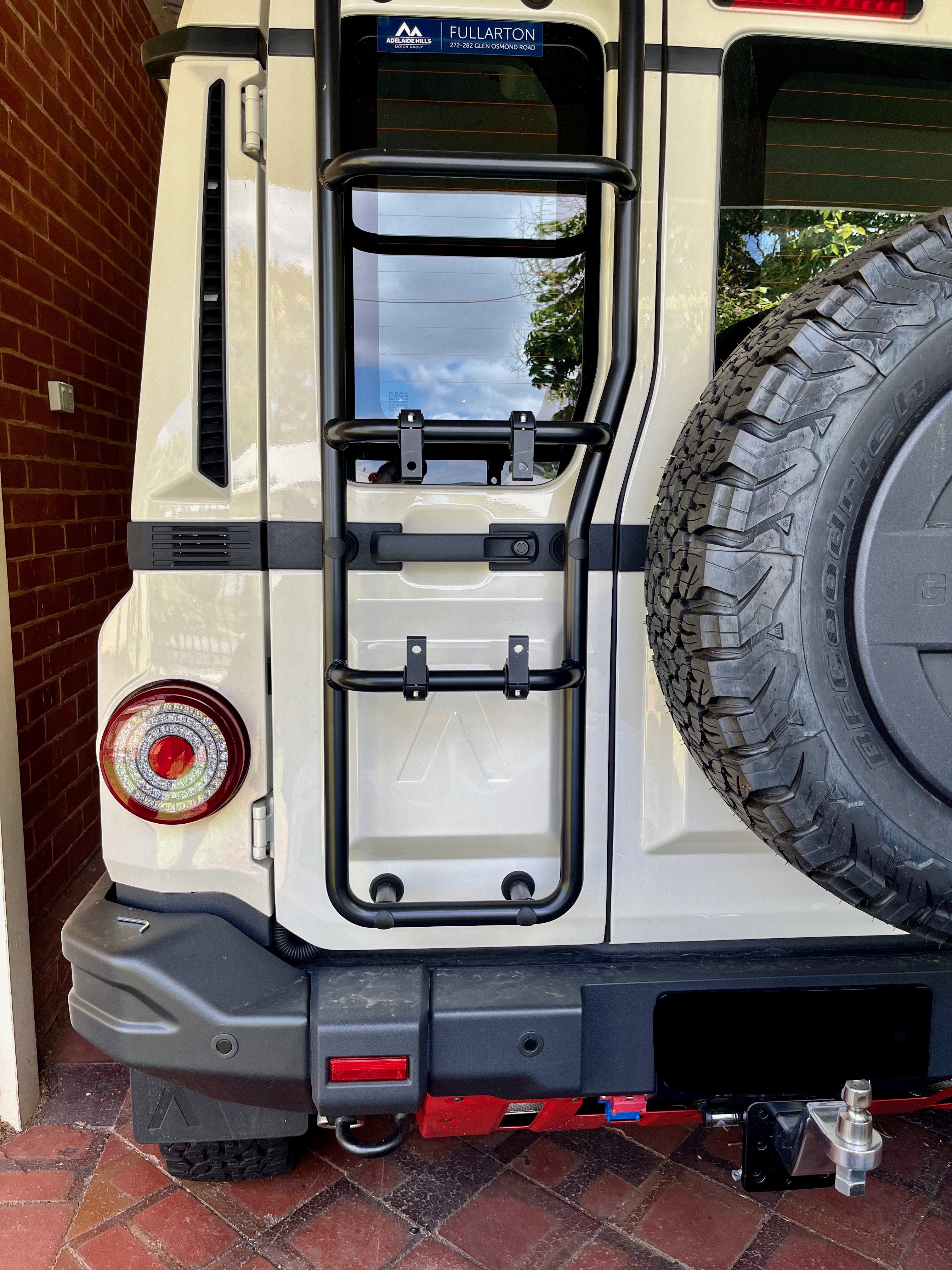

Thanks for posting I was wondering how to mount Maxtraxs on the ladder. Your system should work for all 3 sizes of Maxtrax. Nice to have choices, if I need weight off the roof rack.

The other method @TheDocAUS is to use the Maxtrax spare wheel mount. It functions the same way secured around the ladder as it does when used as designed.

@MattG One question: Access to the door handle from the side between ladder and spare wheel? looks very narrow

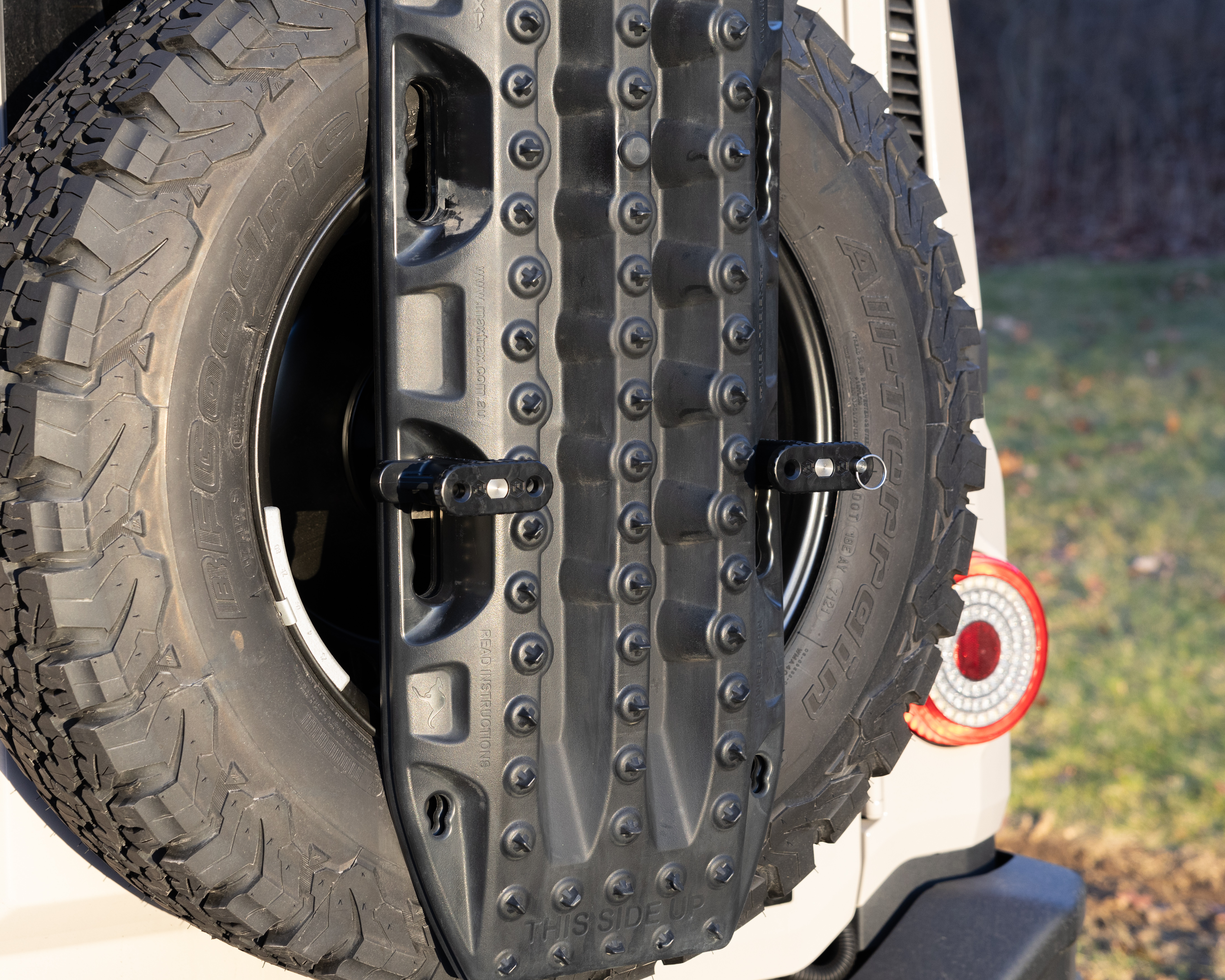

I do like the spare tire mount except..... my ocd couldn't live with that 2" or 3" sticking out the top over the roof like in that first picture

Interesting approach! I'm in a similar boat with height restrictions. I am choosing not to use the MaxTrax spare tire mount because I ordered the tire storage box and plan to keep recovery gear there - having to take the boards off every time I want to get a strap seems like it would get 'old.'
