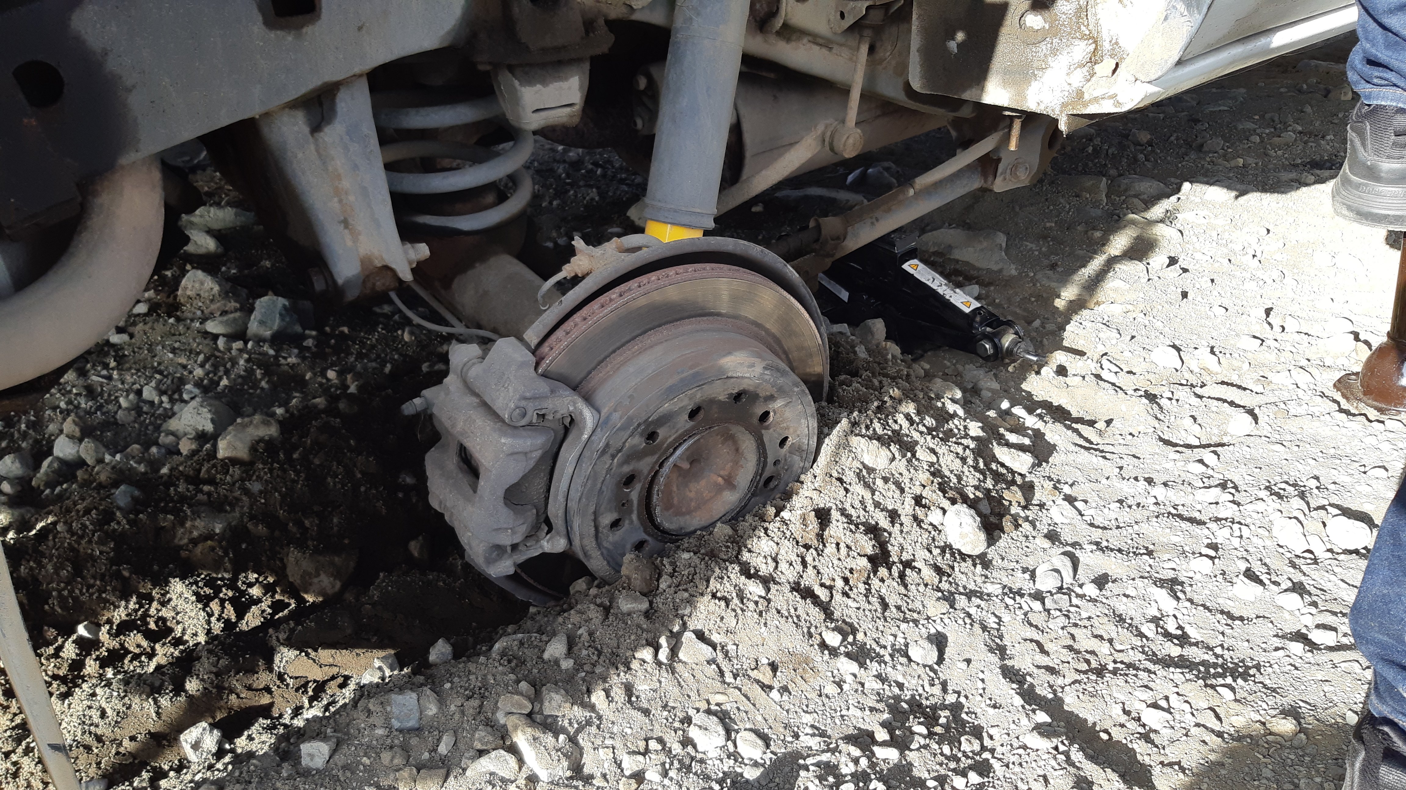

For offroad driving I prefer a scissor jack, clearly.
In such a situation (happened on Iceland) it's your only choice to get the axle liftet.
AWo
But in the case I showed, you need a large Hi-Lift, as the axle has a lot of travel. Better put the jack under the axle, then it lifts immediately.
AWo
AWo
If the wheel is still on, you lift the wheel. There is an attachment for the Hi-Lift to do that. But there are lots of ways to solve that problem, of course.
