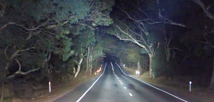

This is my concern with lights such as the Lightforce Venoms and many other round driving lights.
They tend to go for long distance cone of light with a circular beam pattern.
They are not very expensive so I guess you get what you pay for and at 150 mm Grenx no doubt was getting the best he could that fit nicely in the grill.
Interesting they don't show any photometric data for the standard light.
It is supplied with a "spot" filter to fit over the light and you can buy a combo filter but neither do a great job of lighting the sides of the road and seem to focus on what's happening a kilometre up the road.
Roos tend to come out from the side of the road rather than drop from the tree's.

The addition of a Lightforce Viper 20 inch LED bar (single) works really well with the OEM high beams and spot lights (installed under Roo Bar hoop). Those with similar setups seem happy as well. Light is very even cross my setup and the colour temps match. I found it so good I thought I did not need the 40 inch OEM rooftop mounted lightbar (which I already had, but now rarely use).
