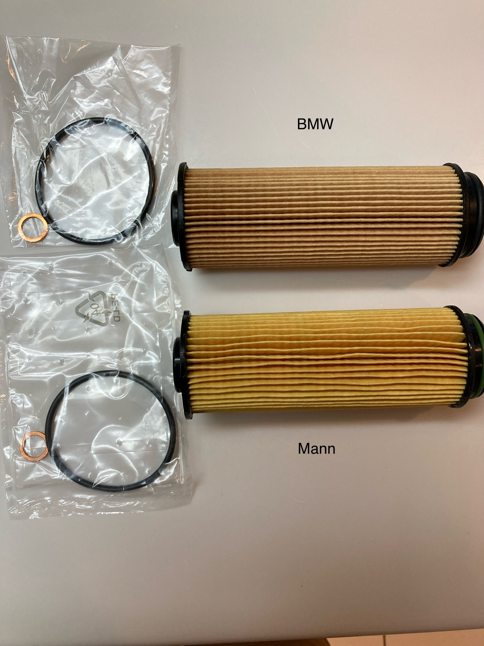

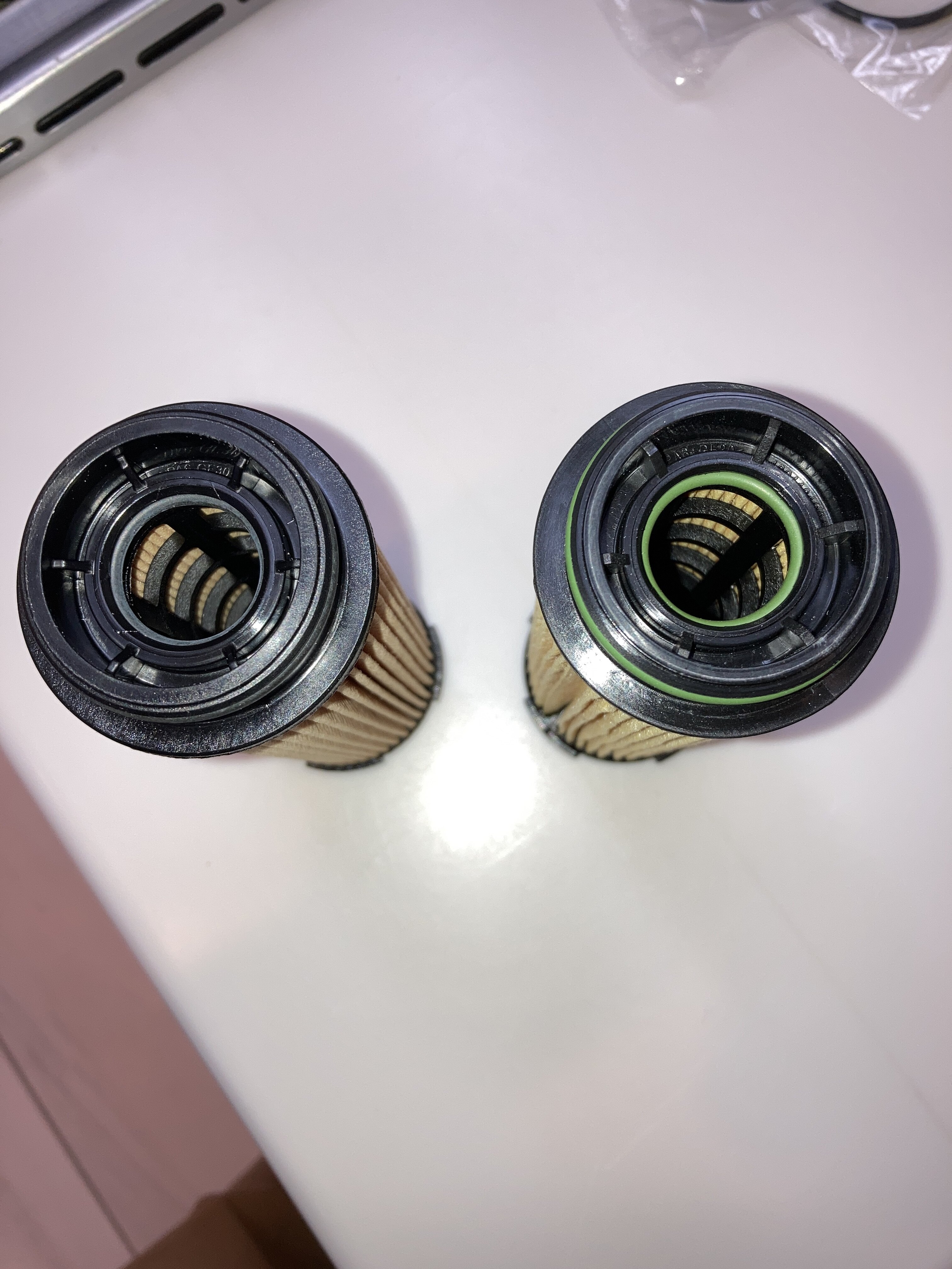

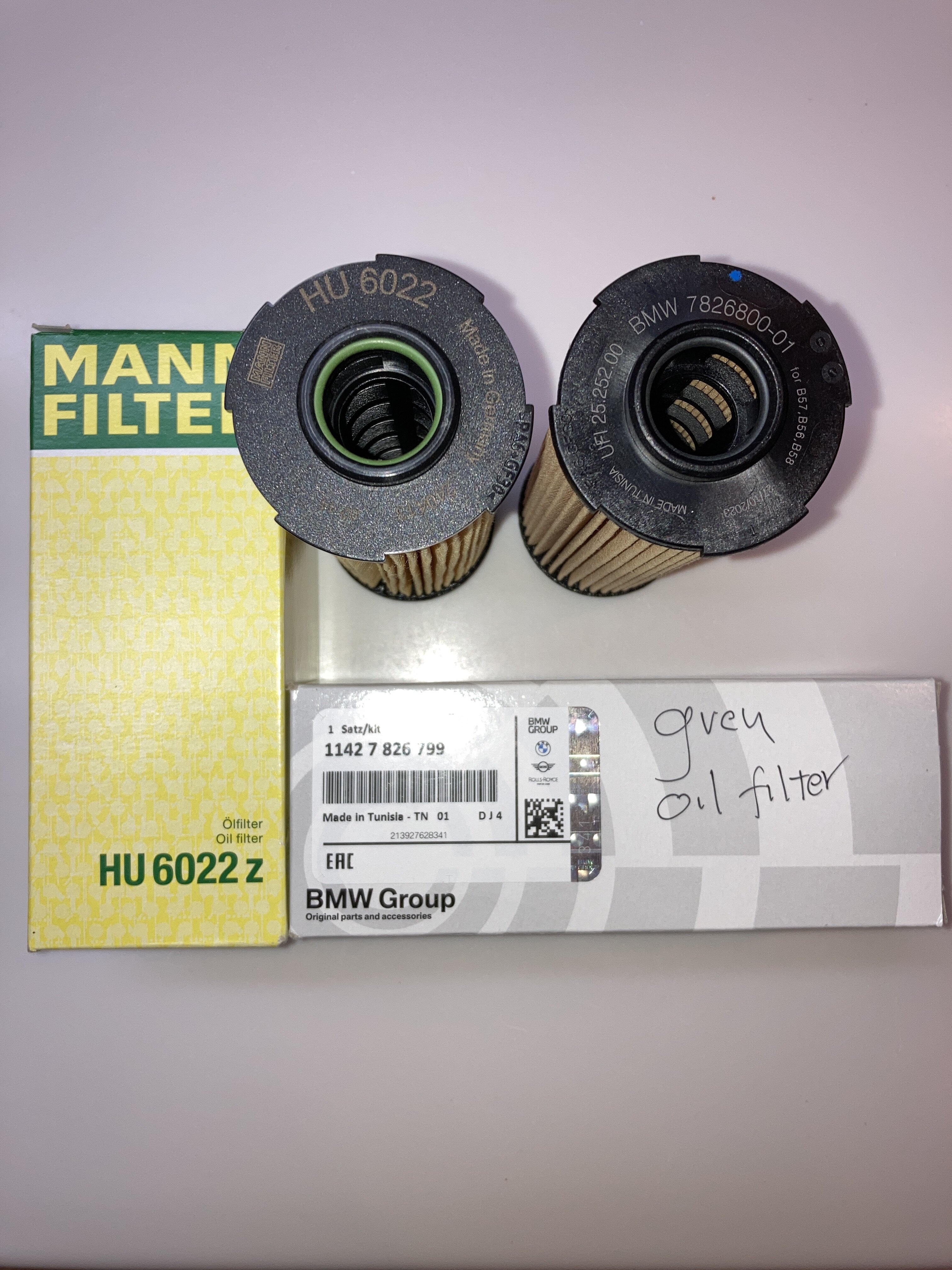

Is there any reason to use the OEM BMW oil filter versus the aftermarket Mann filter? Superficially, they look identical.
