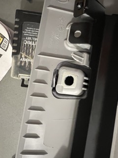

There is no difference in the sides. The reason for no grab handle on the drivers side is possible field of view impacts. There are a few vehicles in Aus now with the grab handle fitted to the drivers side. My wife and I were lucky to be able to test it in someone else's car for field of vision at the recent SEQLD Owners get together. My wife being shorter than me finds it significantly easier to get in with it, and neither of us found it gets in the way of vision.
You can get if fitted by a dealer if you so wish. The small trims are amazingly expensive so you can just buy the handle part and the screws are exceptional value. The mounting blocks and all the pieces are identical to the left side ... what you can do is creatively cut the cutouts on the A pillar trim to fit the handle. I did it using tracing paper roughly modelling the cutout from the left side to the rights side, then a couple of hole saw holds and chewing out just the clearance for the handle. A couple of hours beginning to end last night.
Parts:
  • Grab Handle (universal) GRA-07000-022530 was AUD$266 (makes the 78 Euro someone posted earlier look like a real bargain)
  • The two screws GRA-0000-000150 were $1.56
Did away with the covers - and I am looking at 3D Scan/Print of my left hand side pair (which are mirror image parts so a scan of one might be enough and then flip it in CAD)
Handle fit from the underside - (original handle, manufacturer original cutout LHD pillar in Aus): shows quite a lot of clearance on both pieces (the little spigots are different sizes at each end - and the bigger one is obscured by the metal plate on the right)
Old school with the tracing paper and a highlight to show you where the pencil lead traced onto, and the end result with the two pieces side by side (it didn't have to be perfect I just nibbled enough out after the hole saw cuts to get the handle to fit).

You have to stick your head past the wheel to see the missing covers (or look through the windscreen) - so I poked the iPhone in there and took this slightly out of focus shot: (And for the curious folks, that's a Safety Dave caravan reversing camera monitor sitting next to it - just shuffled a little further in).
