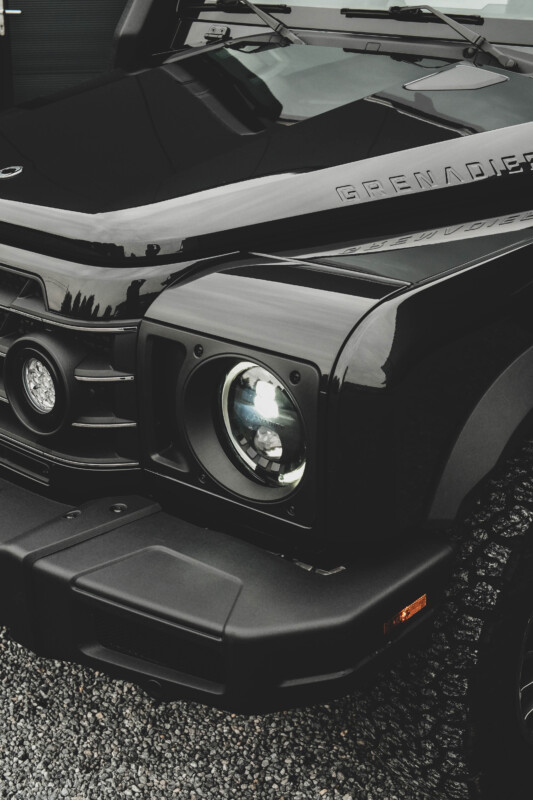

Expensive but nice!
Lights
That is a great install. I go back and forth between something like that, or a light bar on my roof rack. I’ll most likely go light bar due to the factory connectors and switches (plus adding a reverse work light).
