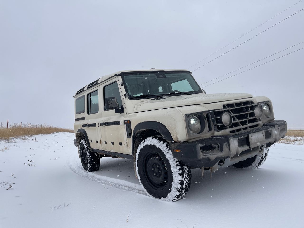

First thing I wanted to do was replace the 265/70/17 BFG KO2's
I considered several tires in the 255/80/17 size, Toyo Open CountryIII's, Falken Wild Peak AT4W, Mickey Thompson Baja Boss AT, and the new Goodyear Duratrac RT.
My logic behind choosing that particular size,
I've always felt that 255 width was a great choice because it put more LBs/square inch to the ground, Good for snow traction and cutting down when driving thru mud. The downside to the narrower than the standard 265 is it feels a bit twitchy on dry pavement. Steering input seems quicker and and maybe the loss of a little stability.
The profile ratio of 80 gives a little more cushion and rolling resistance over uneven ground (not that that be achieved by another tire size in a 33-35" tall tire.
I also wanted to go only as far up in size as a 33" tall tire. One reason is I knew I'd have no issues mounting it on the rear door and no stress on the door hinges. Very small power loss from the engine and the transmission would have no trouble running 8th gear. Lastly, the weight of the tire increases only by a couple pounds (Tire choice dependent)
I ended up choosing the DuraTrac RT. A new release from GoodYear, now with a 3 ply sidewall, some Kevlar reenforcing, more siping than the old DT, a great looking sidewall profile with a new design of the side biters.
And from a personal perspective I always thought the old Defenders and Land Cruisers just looked more Utilitarian with the tall skinnies!
I have no problem with any rubbing, the transmission has no issues of hunting for the right gear, It sits in 8th when driving down the hiway at 55mph. I continue to see if my MPG suffers or gets better than the 265/70's.

Do the Duratracs have the 3 Peak symbol? When I look at it on the Goodyear site, they imply that they are 3 peak rated, but Discount Tire indicates they are not. Sorry to keep asking questions, but we have basically the same base build (if mine ever gets out of the port and to the dealer) and the same thoughts as far as tire size and tire choice.

Yes this size (255/80/17) is 3Peak rated and load range E.
It was very snowy and icy on road today and I'll say these handle better than the older DuraTrac. More sipes, combine that with the weight of truck and the 4wheel drive system it felt very connected and slip was minimal. The snow was wet and slushy. IMHO, a much better snow tire than the BFG KO2..
47psi, (which I think may be a bit overinflated) and only 500 miles on the tires. So I'd expect they are at their peak traction preformance.
Note: I did buy these at Discount Tire in Falcon CO

The tires look great! Is there enough clearance to open the left back door with the spare being that size? It's not clear from your photo.
With a 255/80/17, yes there is
