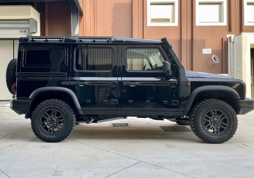

Did anyone here got to know what a good rate of the Eibach springs are for a QM?
I would like to lift mine myself later on, but there seem to be some different variants for added weight?
If you look at this page from Eibach they mention different kinds of spring rates for the rear ones?
The QM could need those when loaded up i suppose?

I’d say think about what you will be doing with it. It would be tempting to go with a heavy weight spring but if you only load it occasionally then it will be a hard bouncy ride the rest of the time. If you are running a canopy or a camper body then match the springs to the weight of that..
Check out this thread I started on QM springs. I have one on order with delivery in US in Q2. We figured out the spring in front is the same as the back in SW but rear is a different spring. QM Reviews have stated a stiffer ride unloaded. More 4X4 out of Australia showed a great airbag system that is managed internally on the above switch panel. Part of their GVM upgrade. That is route I am going
