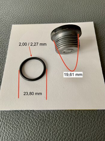

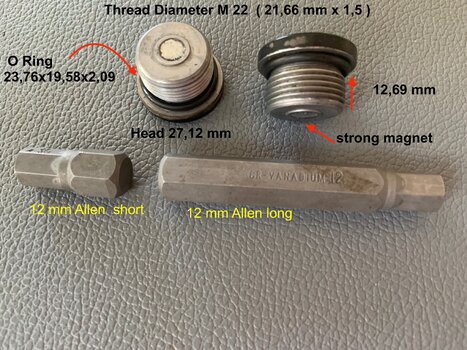

This is not !!! the INEOS tool, but it should be similar. But make sure you do not drop the tool into the differential !
