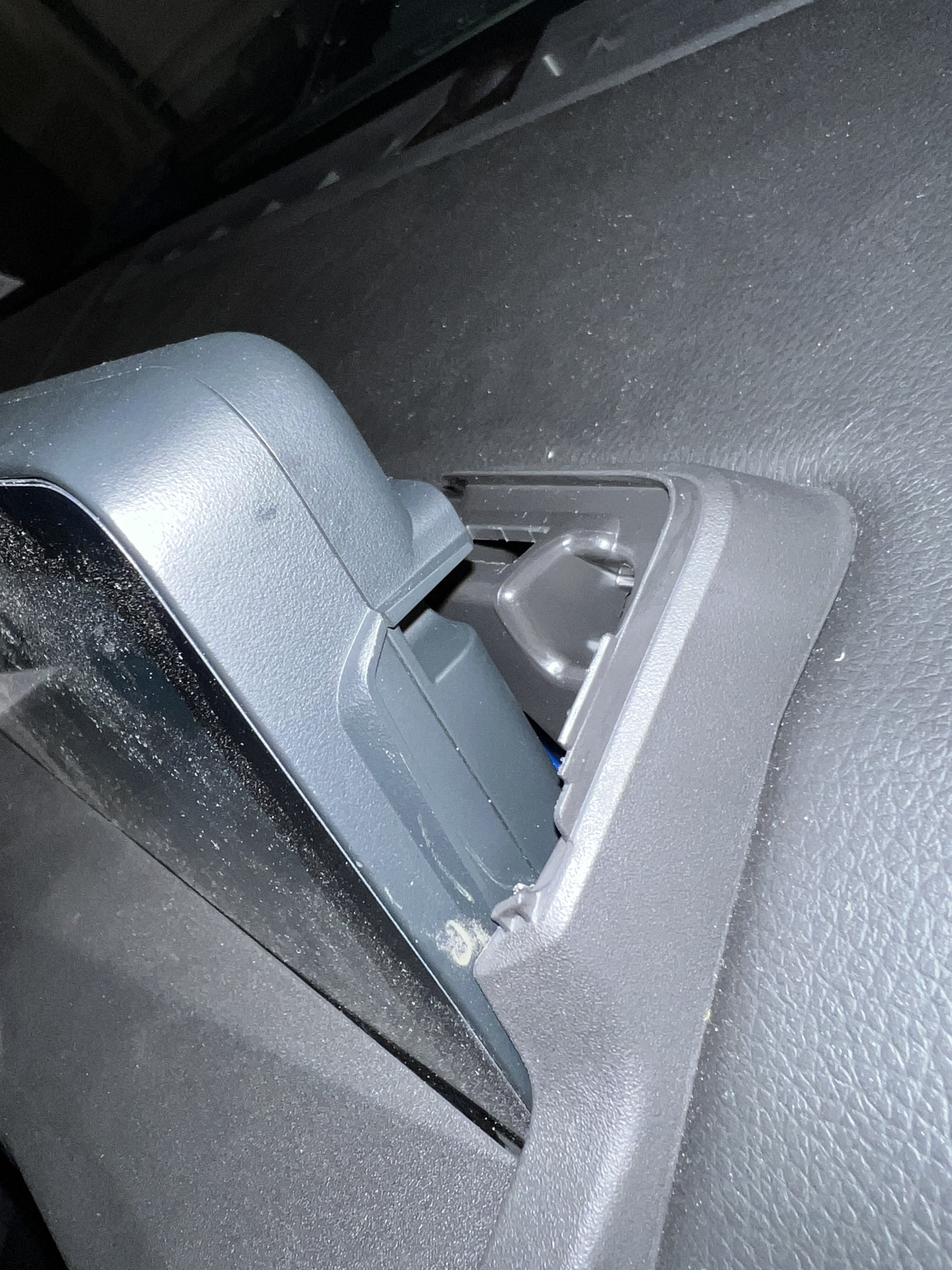

I’m getting a creaking/vibrating sound that seems to be coming from the infotainment screen. It stops when I gently push or pull on the screen. Is this what you are experiencing and has anyone else had the issue?
I have the same issue. I cut a piece of paperboard to slip between the infotainment unit and the base attachment in the rear and it seems to have helped. If I knew how to disassemble the unit, I would take it off the base and put felt tape all around the base and then reassemble.
That’s exactly what I was gonna try. Thanks

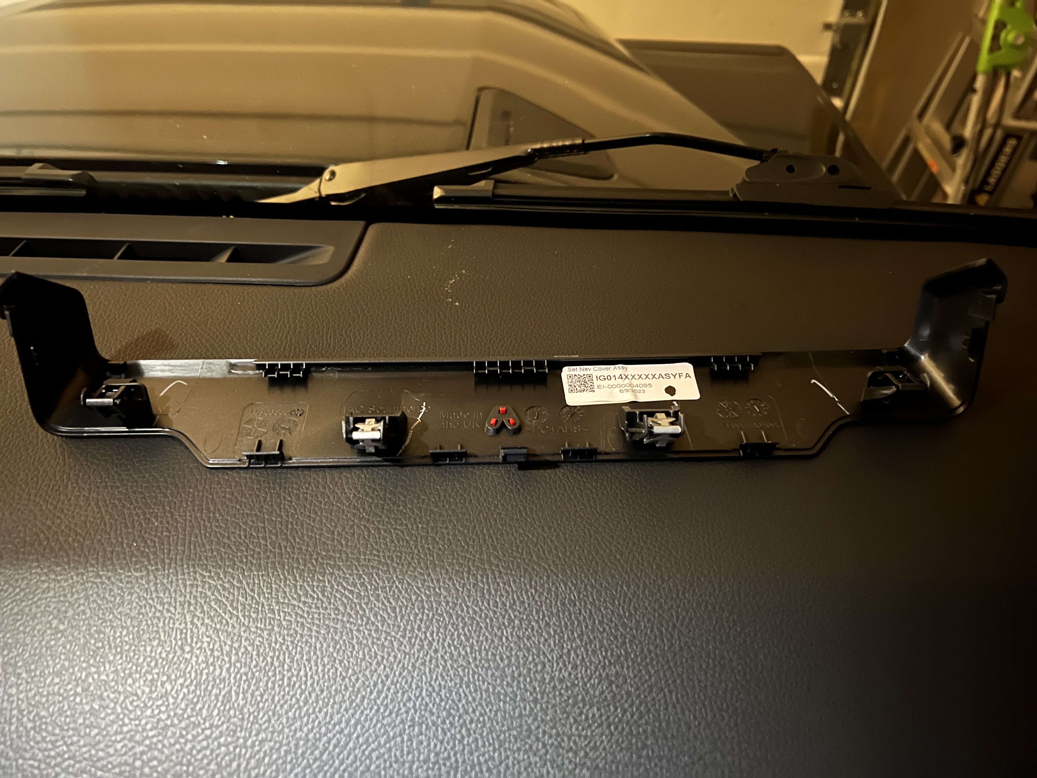

The cover is actually easy to take it off, 4 clips on the back and 2 small tabs on the side. I started on one corner with a trim tool and worked my way around until I popped all the tabs.
Edit: No noise after I removed the cover. I think I need a thin strip of felt tape above the ledge in the back.

I used a strip of 1/8" speaker foam tape across the front-facing edge of the screen (where that ridge is) and it cured any rattles I had from there
