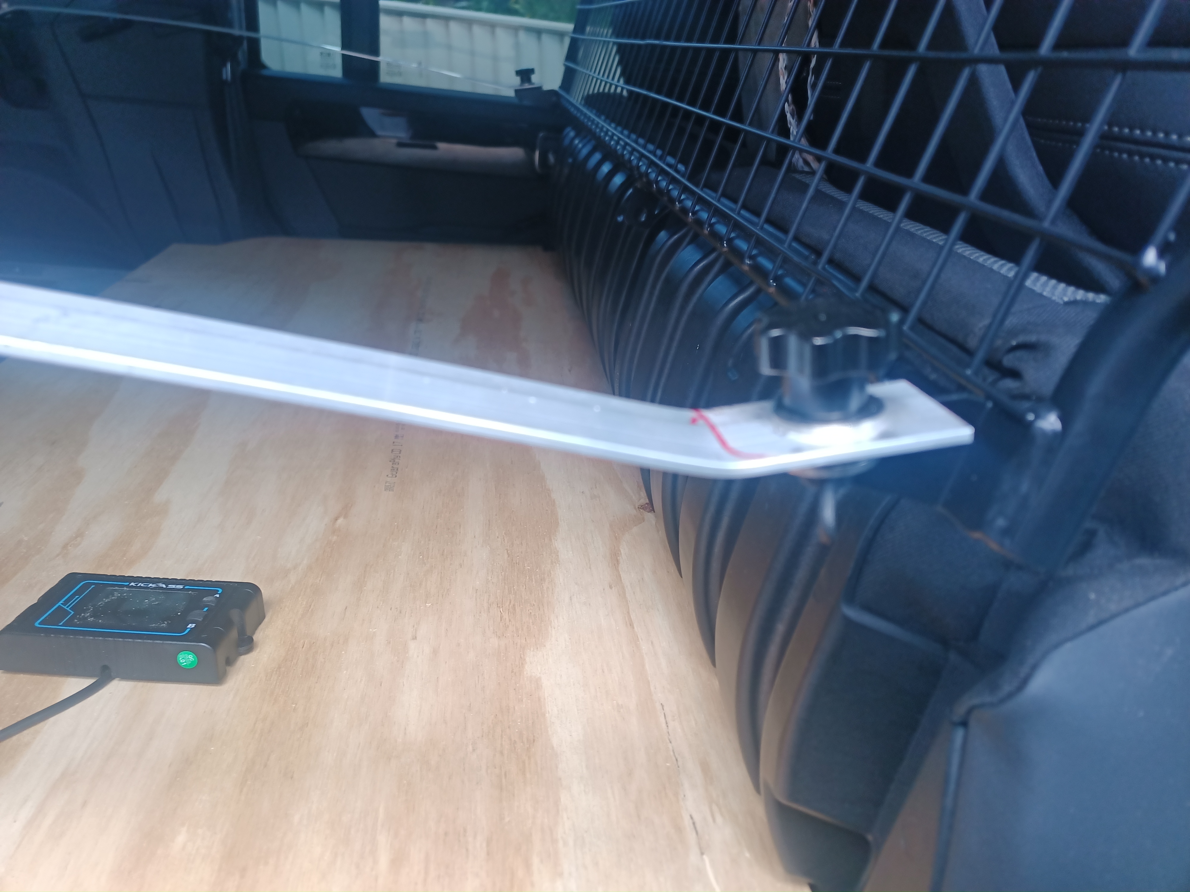

I have bad news for you. The half height barrier cannot be moved behind the front seats as it comes delivered. I can't make it work and nor can my dealer or agent. Take a look at the bottom paragraph on page 1.
Since there are no commercially available cargo barriers to go behind the front seats, I have started the journey of designing and building one. I will make it in accordance with the Australian Standard but i won't have it externally tested.
It should be relatively easy. Albeit, time consuming.
I can't bear the thought of doing a desert crossing or the Canning with the seats down and no barrier to stop stuff falling all over me. Never mind what happens if I have an accident.
Hi Andrew, have you made one yet?
This is what I did to make the barrier work behind the front seats. It seems to work quite well. The bolts into the roof are 8mm cup head bolts. I intend to remake it in steel and use 10mm cup head bolts which I have checked and fit quite nicely.

This is the post where I detail what I have done. It works a treat, but when i get time i will remake in steel not the aluminium that the prototype was made of. Note that I do not claim that this complies with any standard, it is just my work around but in my opinion is better than having no protection.
Let me know if I can help more.
