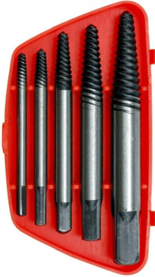

Need to hit the outer diameter with a large pin punch then use a smaller diameter pin punch down the center. Knock in the burred torx edges use either a larger torx bit or belt in a square ended cut Allen key. The idea is to broach the hole to give a good drive so drilling the hole may help. Torx are metric so AF allen keys can work better when the bolt loosens gently work back and forwards by hand and remove the bolt. Make sure the doors weight is supported or retighten the previously loosened bolts and remove the last tight bolt. Bolts painted at the factory can be better secured than locktite. There is no avoiding damaging the paint on the bolts so get some touch up paint. If the recessed torx bit heads are totally screwed may need to use a sandard Rh large drill bit to remove the bolt head a Lh drill bit to remove the remaining thread or a Rh drill and easy outs. Use heat as a last resort and after inspecting the opposite side as heat may damage some adhesives, fasteners, sealants.
