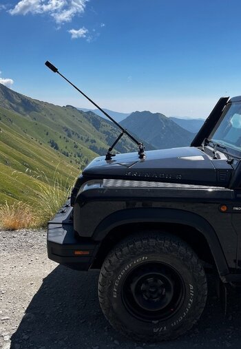

Has anyone with a Lensun bonnet/hood panel tried to fit a suction cup camera mount on the solar panel? I use an Insta360 camera mount to film my trips and I'm concerned the surface of the panel will prevent a good suction grip.

Why not put it off-center, on the free area and angle it towards the center. Given it's a 360 camera, a couple inches shouldn't make much difference.

@LabRat Thats worth trying!
Lensun have confirmed by email: "We don’t recommend using suction cup mounts directly on the surface of our solar panels. While the panel is durable, its surface isn't designed for repeated suction use."
So now we know.
