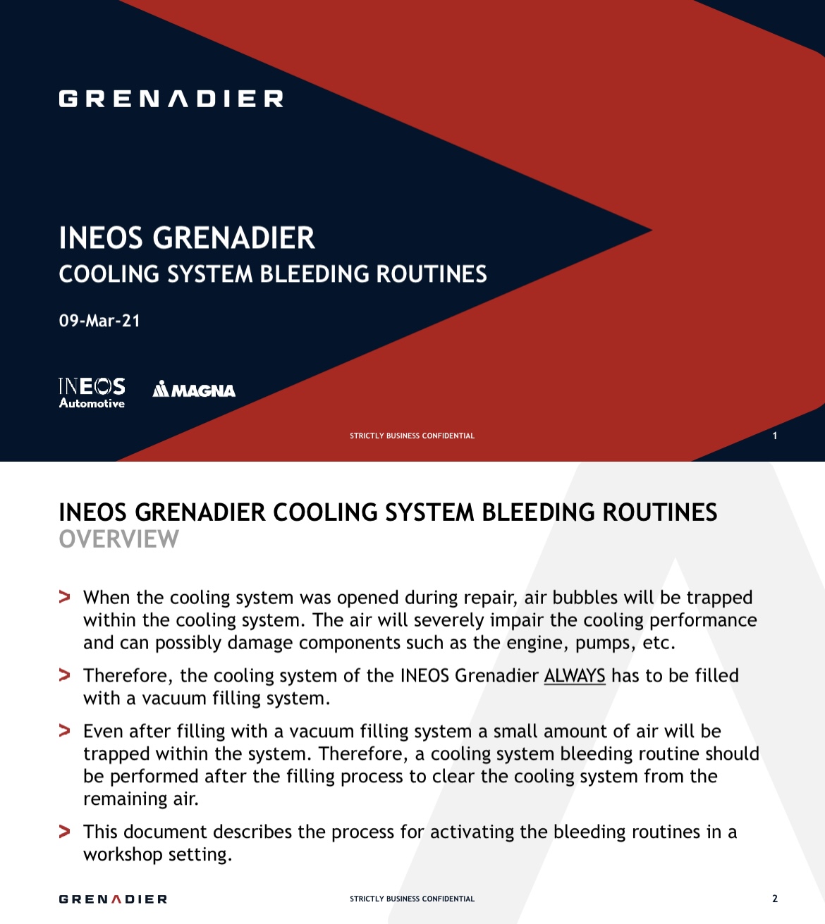

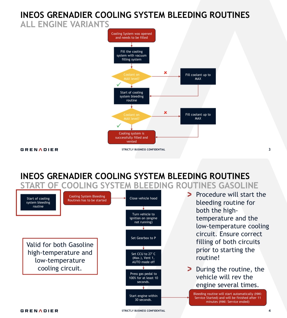

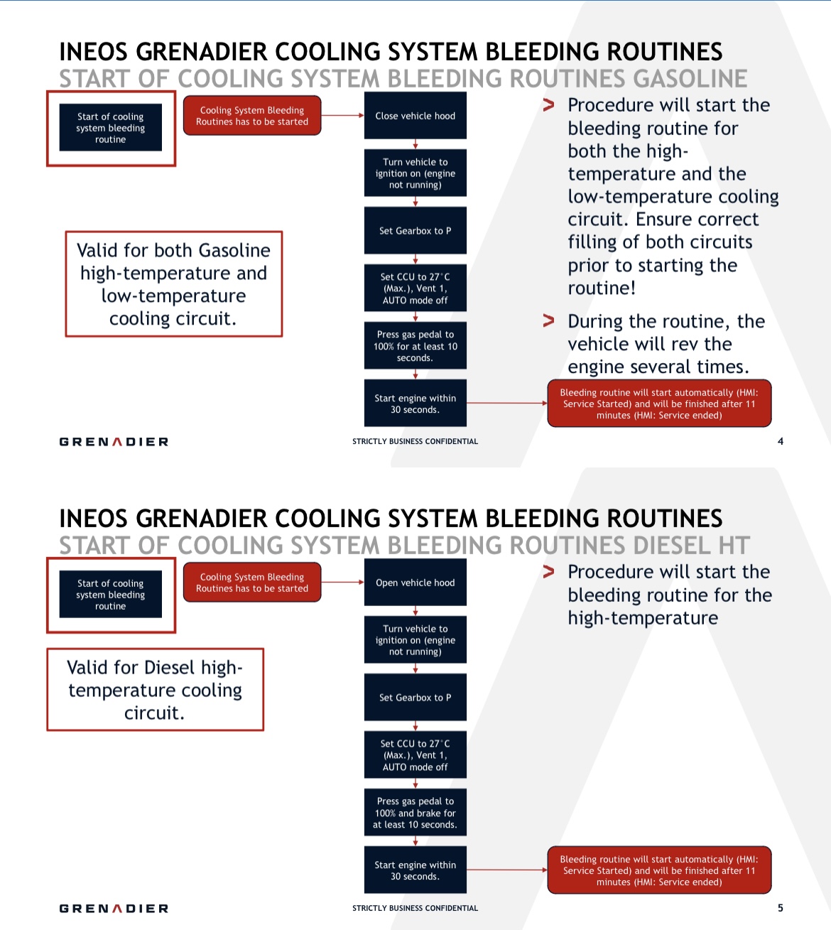

Here is the information from the technical bulletin for bleeding the cooling system.
Unfortunately my dealer are reporting that bleeding the cooling system has not cured our cars lack of heat in the cab. They are awaiting further input from Ineos technical. I wonder if the system will need bleeding several times for a particularly stubborn air lock?
Thanks for sharing.
Apparently mine took many attempts ……..
