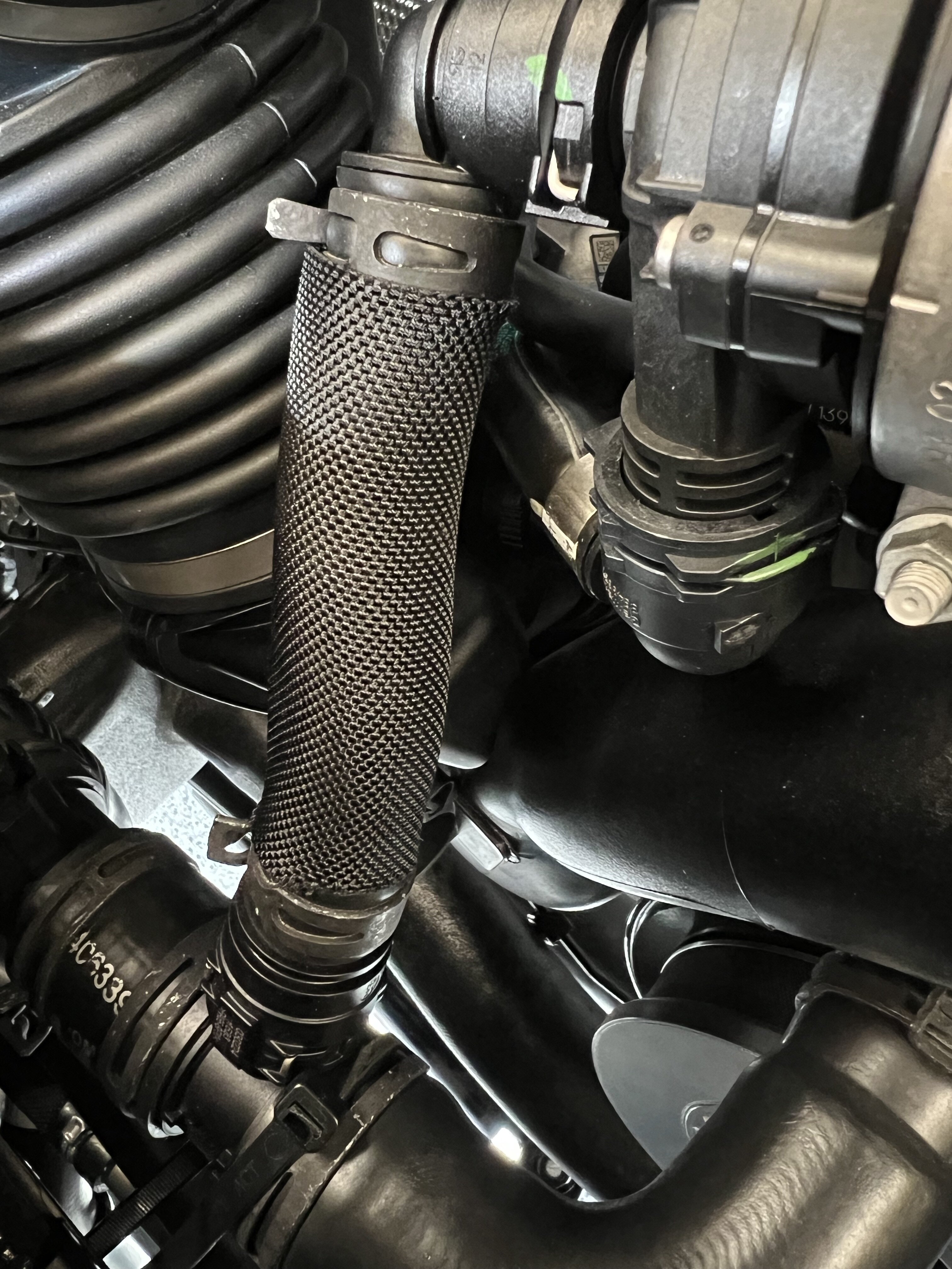

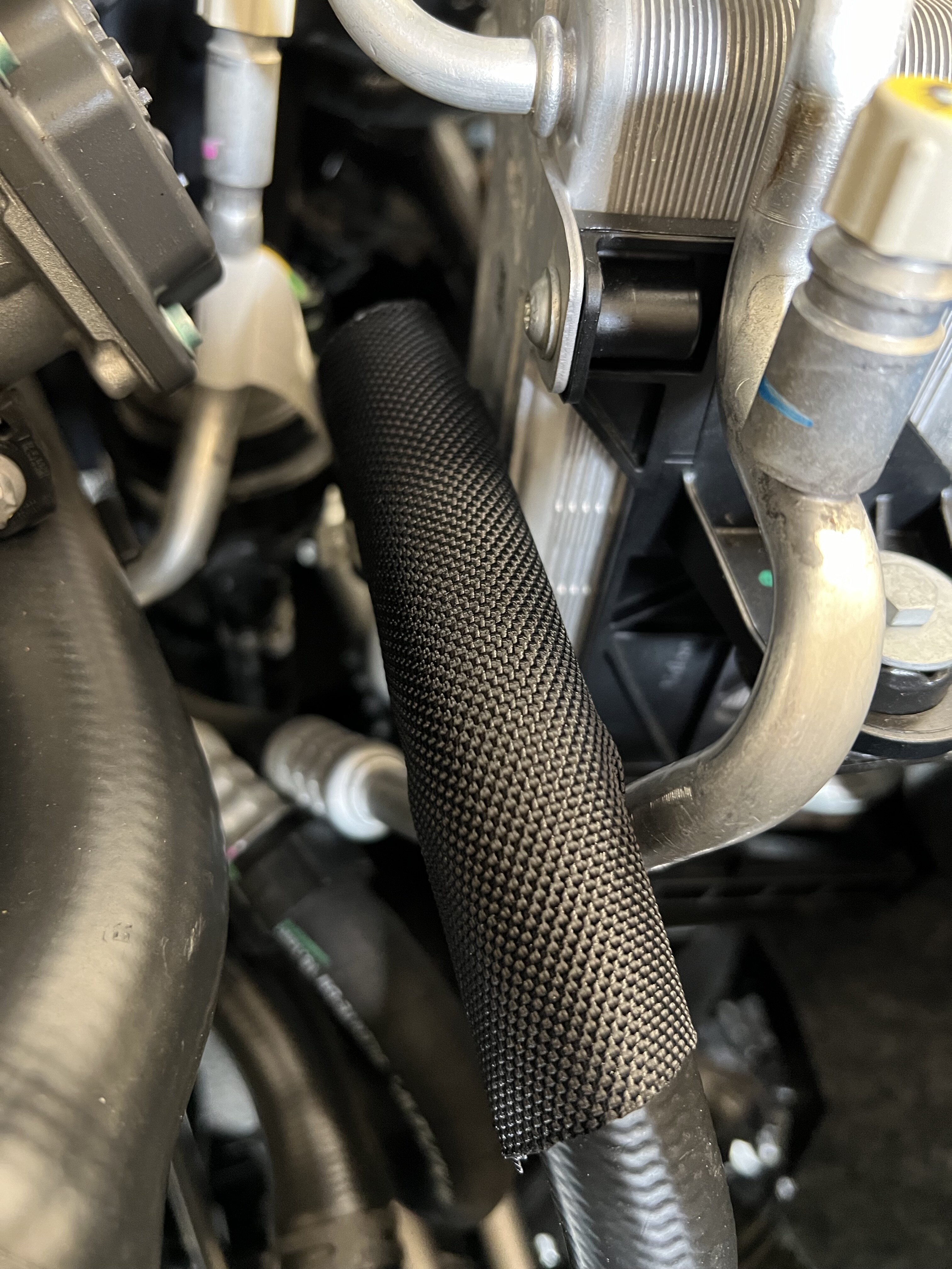

I lay odds that it’ll be one of the many 1” (25mm) coolant lines that either chafed through (as the under hood routings are a bit suspect) or one of the many spring clips was not installed correctly and leaked. I brought home my brand new Fieldmaster and after a couple of days found coolant on the ground as one of the spring clips taking coolant to the front right radiatior in the bumper was leaking under pressure. I repositioned the spring clip to sit more square on the hose and barbed fitting it was going into and that stopped the leak.
Needless to say, I now watch all the coolant lines like a hawk as I don’t fully trust how the hoses are plumbed and can see many spots where they rub against each other or various other sharp objects under the hood. I even went as far as to put anti abrasion wrap around all the worrisome spots I could find.
