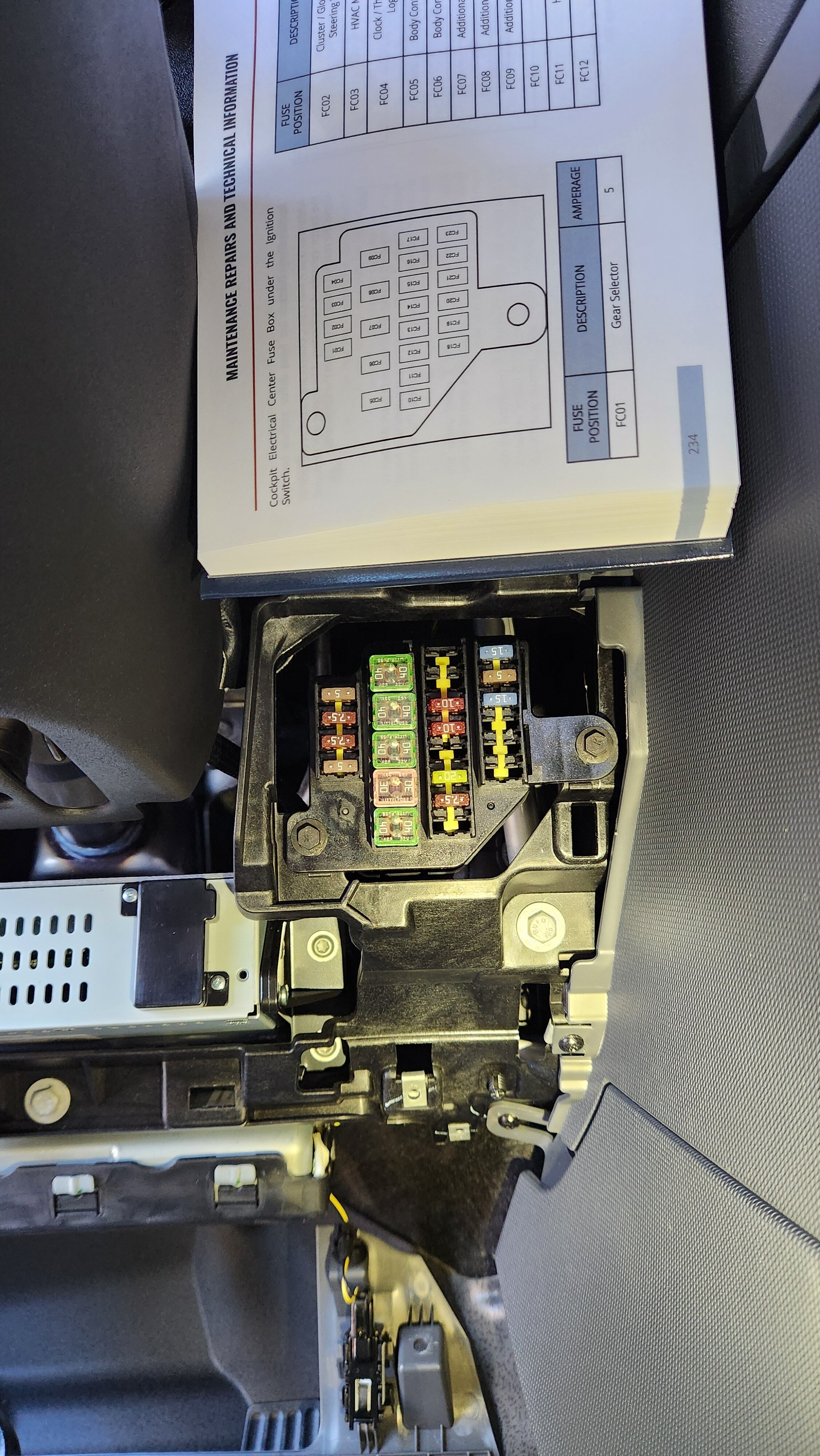

I use the rear to charge my phone because I think it's easier - the charge being faster is just a bonus IMO. We installed a pair of ports on the passenger side for the wife over the weekend, wired to INT2.
Mind sharing a pic and what product you used? I like that idea too
