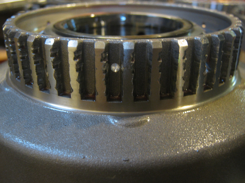

My Disco 200Tdi -93 has a LT77 gearbox with over 600´ km and it has been towing a lot. Still going strong.
Why automatic gearboxes are thought to last forever? Especially with diesel engines they have problems with clutch plates (gearbox and torque converter) and also with cutch housings. Picture from ZF 4HP22 D-clutch:
