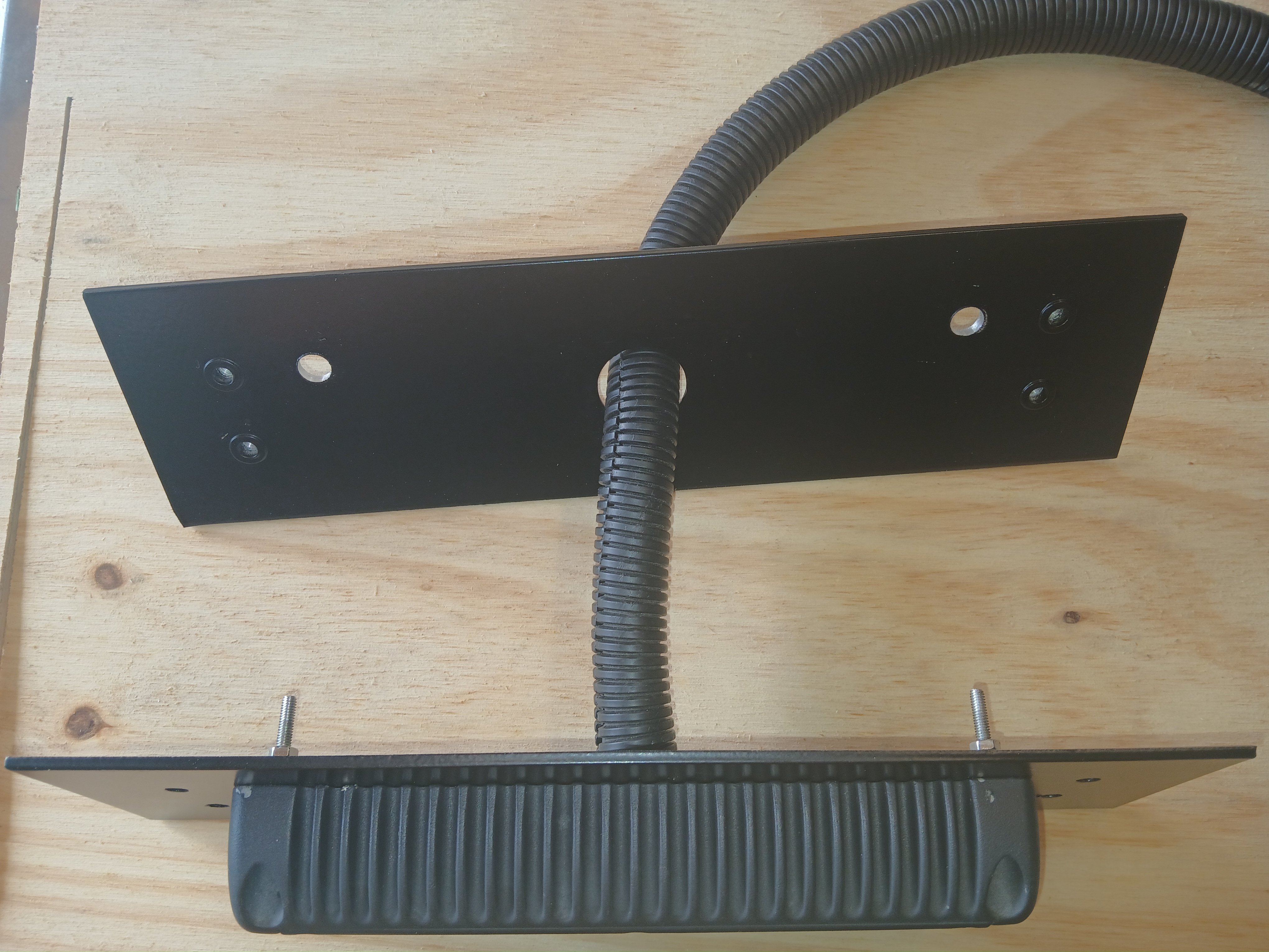

Roof Rack Lights: I wanted something that didn't require drilling, and this is my solution. The two plates clamp together and are larger than the hole in the rack.

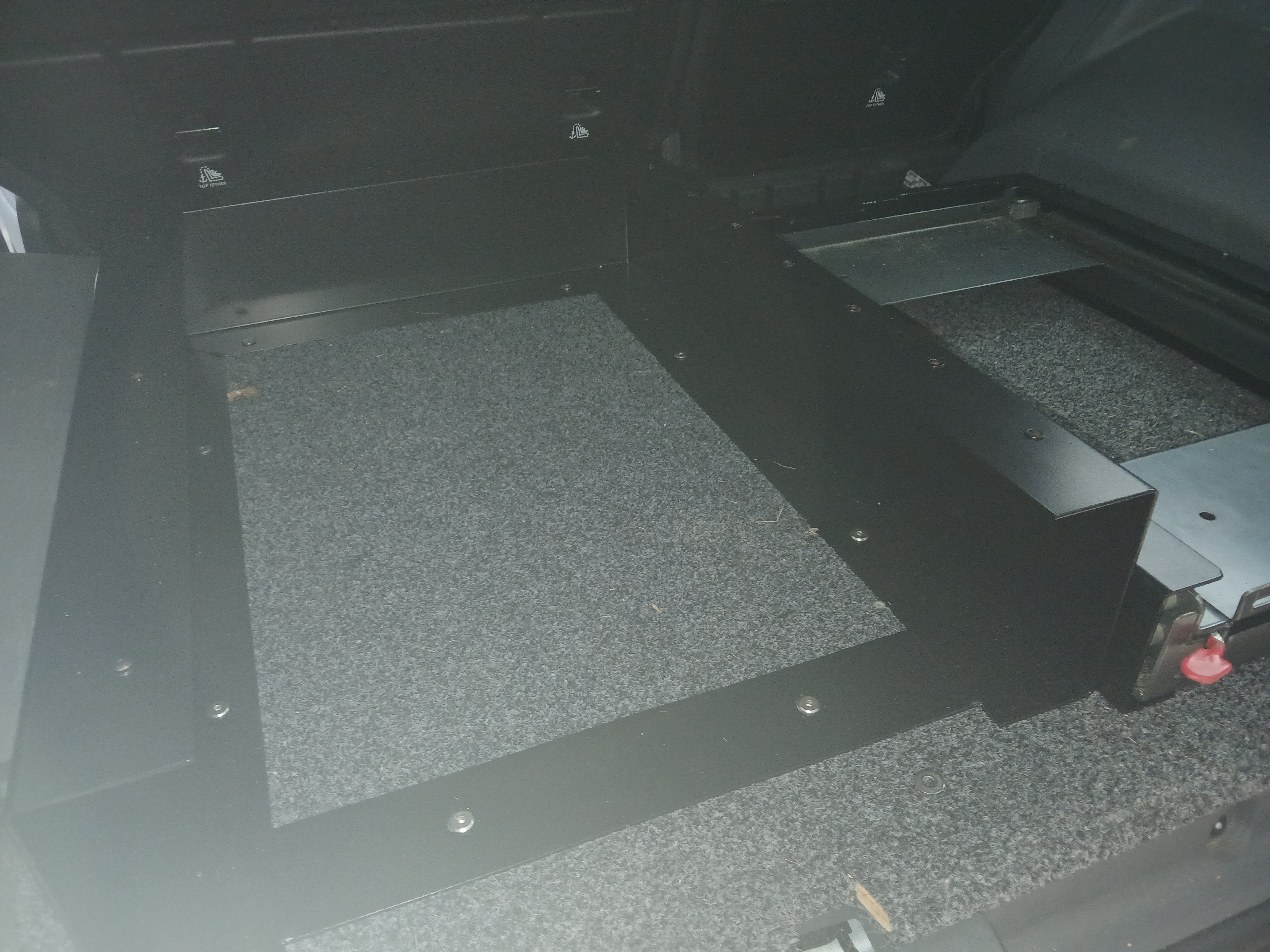

Internal Rear: I fitted a 20mm ply base covered in marine carpet. This is fixed in 4 places using the L Track rails. On to this are mounted 2 off U Sections. The one on the left has a 20mm Ply board covered in marine carpet fixed to it. L Track rails are fitted to the top of it and used to tie down the Front Runner boxes. Under is used to store fold up tables and legs for my cam kitchen. (love the L Track). on the right is another U Section. for day-to-day use a ply board covered in marine carpet is installed. It is deliberately at a lower level to stop stuff sliding around. When touring the fridge cover box is installed. A 100AH battery and DC/DC charger is mounted behind the fridge box and this is hidden when the rear seats are in the upright position.

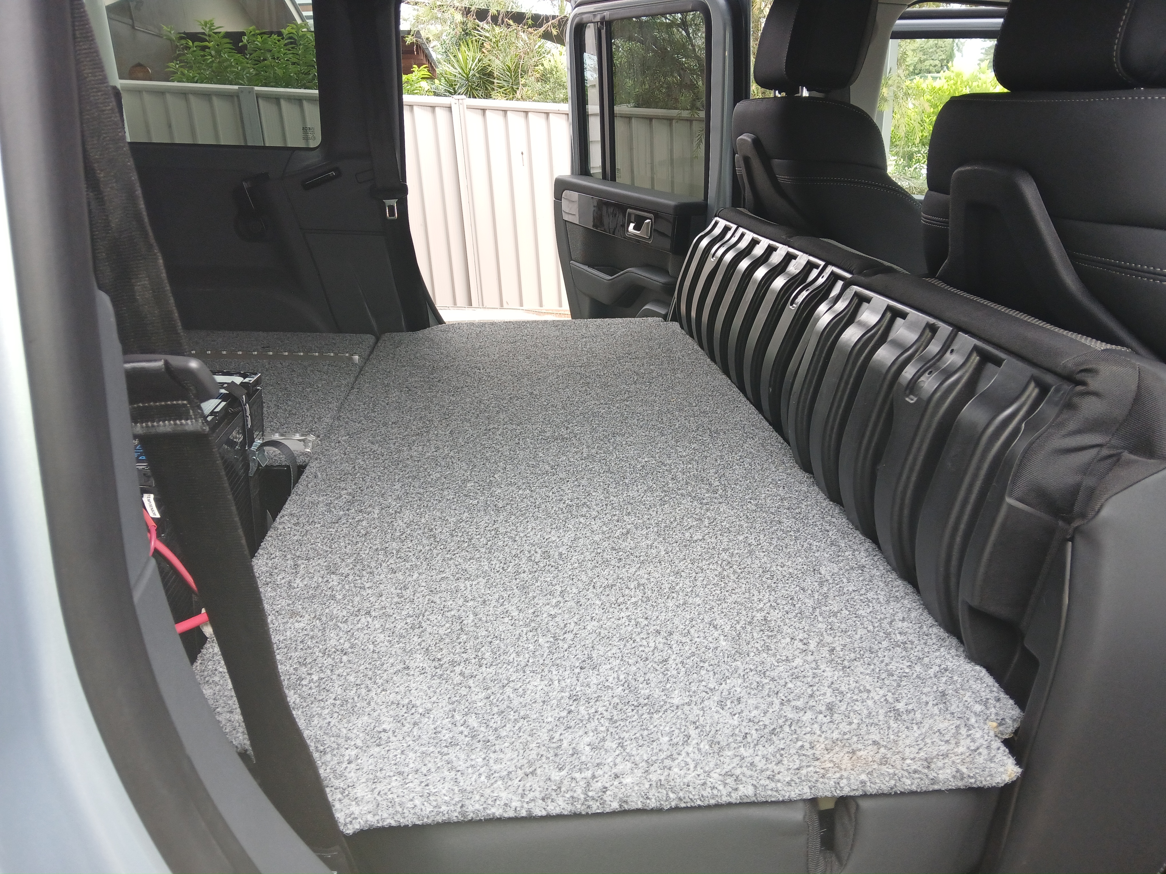

Folded Rear Seat Protector: When the rear seats are folded down i can place the 20mm covered board on them. It fits nicely into a recess on the back of the folded-up seat. I wanted this, not just to protect the seats but also to distribute the load as it can get quite heavy with gear for a long trip.

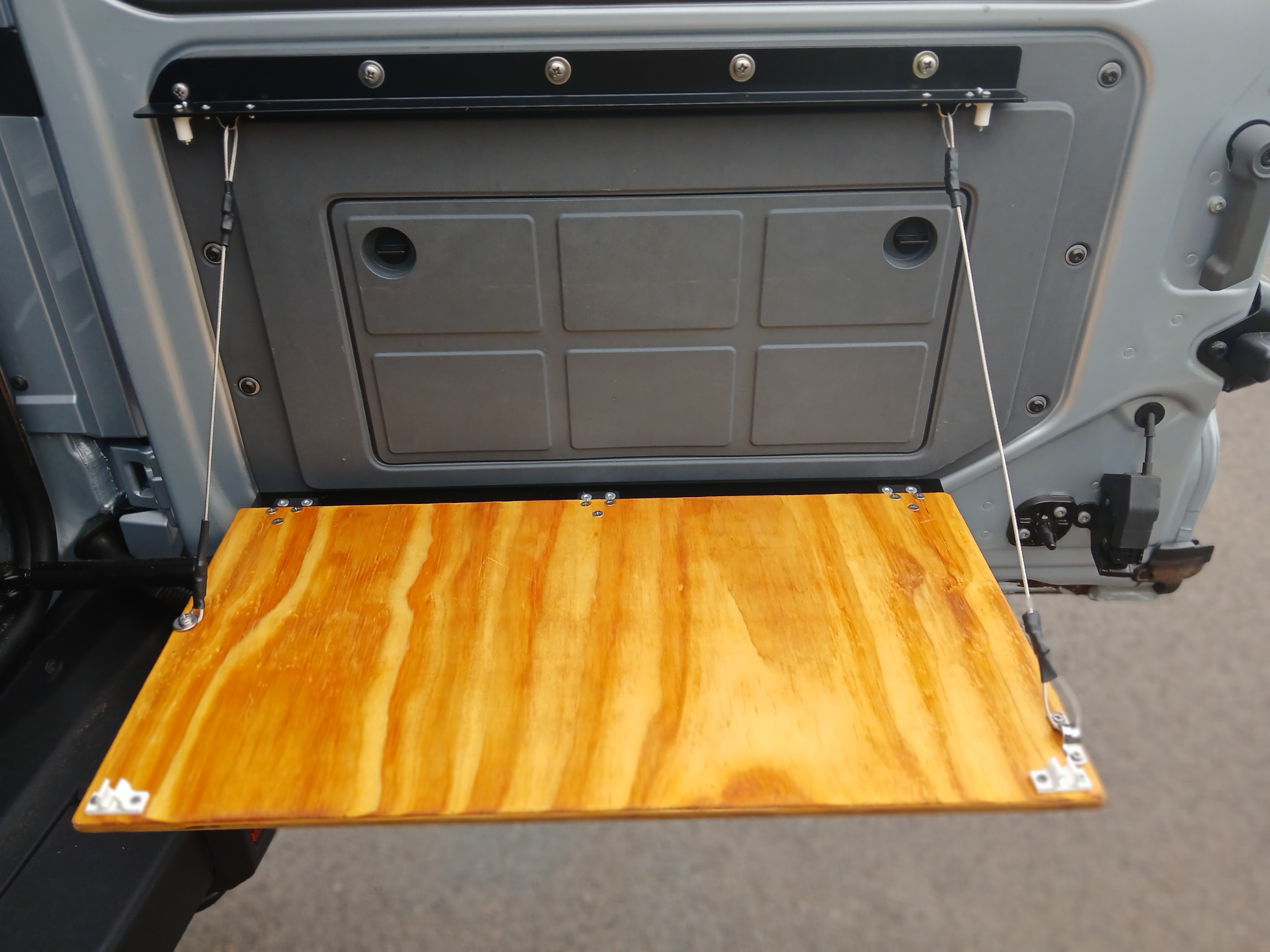

Tailgate Table: Here is my take on the tailgate table. It is designed so the fridge will slide over it, allowing the use of 60% of it to unload the fridge onto.

The base over the back seat has come out well, and I assume the rear table is also your handy work has saved a bunch of cas and is no less functional and easily repairable as well.
Just a suggestion - I would be tempted to coat the underside of the table with some sort of coating to make it look more professional. Probably tactical black 😀 👍
thanks for the tip. It is currently finished with Tongue Oil but i agree the black would look much better.
Everything looks great, I really like the way you mounted your roof lights. If you don't mind what kind of Roof Rack did you go with and are the mounting plates easy to find? thanks
