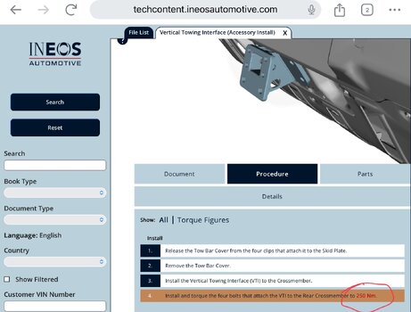

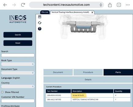

I ordered the same hitch receiver from CAtuned, but the bolts provided are too small. Does anyone know what the correct bolt size and thread pitch is? (2024 Fieldmaster)
The correct bolt size is M16 - 1.5 x 40 hex bolt (x30 or x35 will also work). I found black 10.9 grade bolts at a local industrial hardware store. Thanks to Alex at Overland Garage 4x4 in Laguna Hills for help resolving this.
