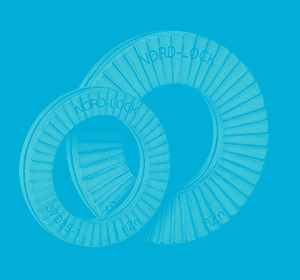

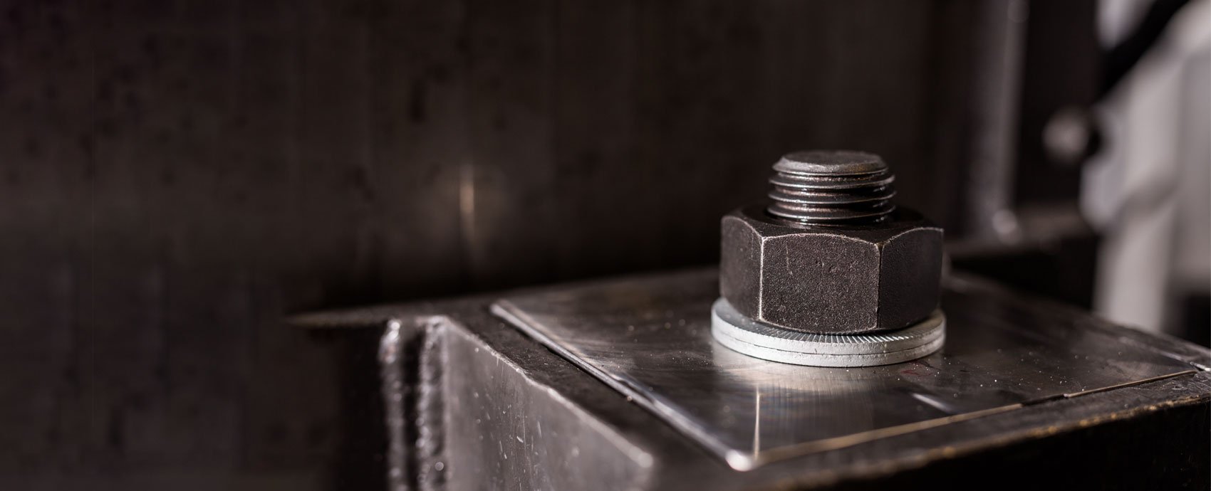

My brother is a mechanical engineer, working and designing high value industrial equipment. He has been super happy with a specialty washer from Nord lock.
The washer basically requires twice the torque to loosen the washer as it takes to lock it in place. And it's not friction based so there is no worry about losing performance with wd40 or grease on the surface on the bolt. My brother raves about it (no affiliation). It's a bit more money at about 50c a washer but for the performance I think it's worth it.
I'm using this on roof rack equipment and other high vibration areas.
This video is pretty good, shows you the performance vs friction based approaches like nylock or spring rings.
McMaster carr carries them. They do come in black oxide stainless steel.
