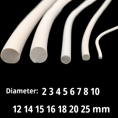

I have a solution for you all.
The dash plastic that sits directly behind the screen chassis, wedge a 5cm long x 2mm dia or square mild density rubber foam rod in the gap between these two elements and squeak is gone. Rattles I cannot help you with.
