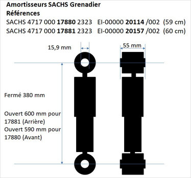

I'm looking for some specific shock data.
I would like to know the static, min, and max lengths, and the eye hole diameter(s).

Here is the data I have with a small difference between front and rear

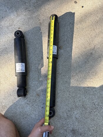

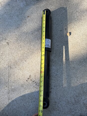

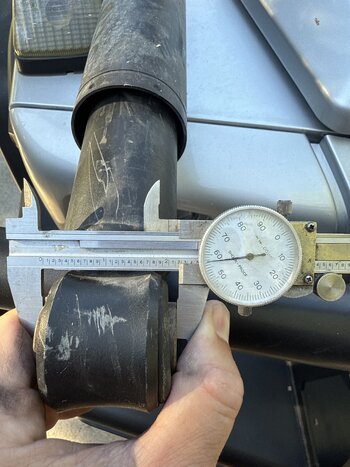

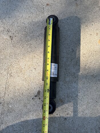

Fronts are just slightly smaller from the factory.
